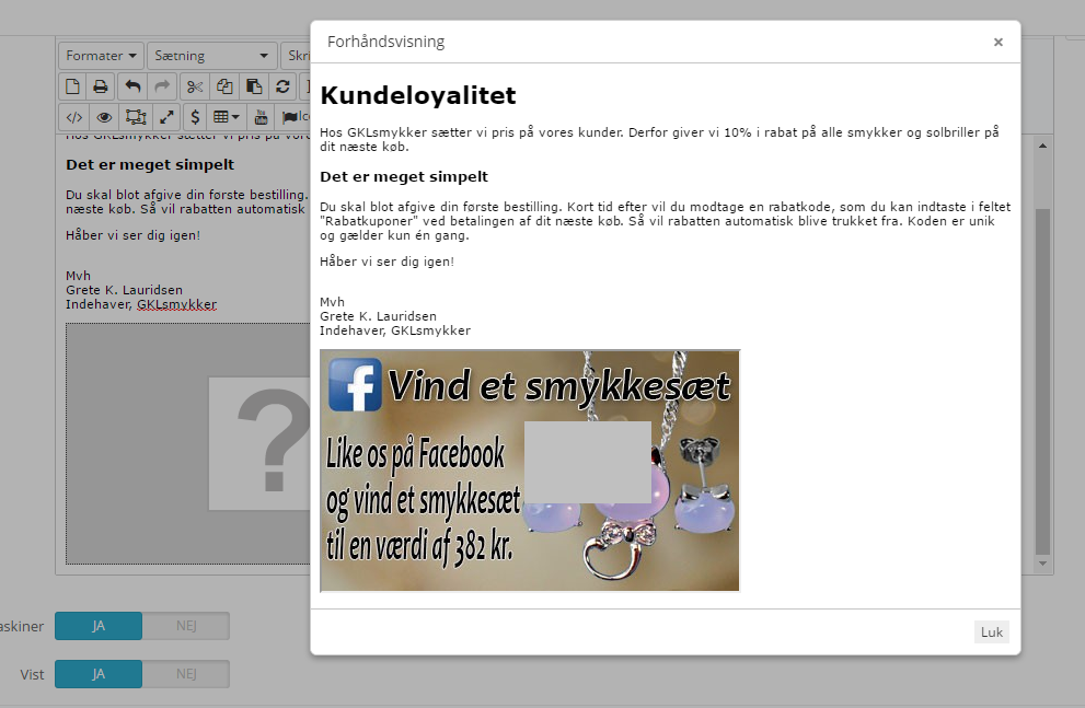

gklsmykker Posted October 4, 2016 Share Posted October 4, 2016 Hi I have some cool animations made in adobe edge animate, and I would like to put them on my webshop. They are in HTML5 and Javascript. I'm not at all smart enough to figure out how to add them into the raw code, so I thought the easiest way would be to make an iframe. I have enabled iframes and disabled HTML purifier in preferences. And I've found some discussions that suggest, that I should also "comment out" the following lines in "Classes / validate.php": if (preg_match('/<[\s]*script/ims', $html) || preg_match('/('.$events.')[\s]*=/ims', $html) || preg_match('/.*script\:/ims', $html)) { return false; } if (!$allow_iframe && preg_match('/<[\s]*(i?frame|form|input|embed|object)/ims', $html)) { return false; } But no matter what, it seems like I'm only able display media content in iframes, like Youtube videoes or regular images - but not html content. Can anyone please help? I use Prestashop version 1.6.1.5. Best regards Grete Lauridsen Link to comment Share on other sites More sharing options...

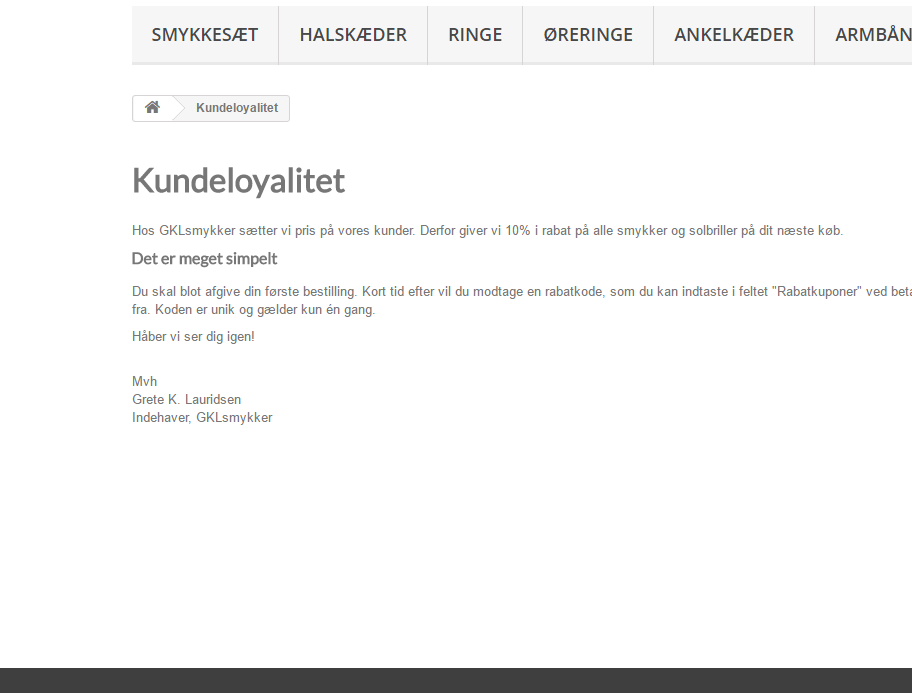

gklsmykker Posted October 15, 2016 Author Share Posted October 15, 2016 (edited) Thanks everyone - and especially Vekia I tried to install tinymce editor but it doesnt' seem to make the iframes work. I can see the content of the iframe in preview mode when I edit the html in backoffice - but not anywhere else (please see the attachements: Iframe_1 is the preview mode in the backoffice - Iframe_2 is what I see in front office - which is just blank) Am I doing something wrong? - The iframe settings is still on allowed and the html purifier is disabled UPDATE: tinymce treats the content as a video - it is an animation, so I guess that's right. I was thinking if there is anywhere where I can specify which video formats is allowed? Edited October 15, 2016 by gklsmykker (see edit history) Link to comment Share on other sites More sharing options...
