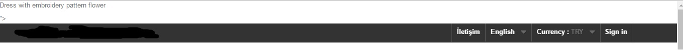

servetsarap Posted September 28, 2016 Share Posted September 28, 2016 (edited) Hello friends, I've 3 different languages at my shop. When i open any of my product with English or Polish, Product's short description is shown at the top of the page. But it doesn't occur at Turkish language. You can check the screenshot. How can I solve that problem? Any help will be really appreciated Edited September 28, 2016 by servetsarap (see edit history) Link to comment Share on other sites More sharing options...
modprestashop Posted September 28, 2016 Share Posted September 28, 2016 From your screenshot it is clear there is structure error in your HTML, one or more paired tag has no matching close tag that is why it happens. Can you share link of your site? 1 Link to comment Share on other sites More sharing options...
servetsarap Posted September 28, 2016 Author Share Posted September 28, 2016 (edited) It's normal with Turkish Language but the problem only exist at Polish and English Languages From your screenshot it is clear there is structure error in your HTML, one or more paired tag has no matching close tag that is why it happens. Can you share link of your site? It's normal with Turkish Language but the problem only exist at Polish and English Languages Edited October 2, 2016 by servetsarap (see edit history) Link to comment Share on other sites More sharing options...
modprestashop Posted September 28, 2016 Share Posted September 28, 2016 So i found the issue. Your twitter description have HTML tag inside attribute value, check here. You need to correct it from wherever it comes. 1 Link to comment Share on other sites More sharing options...

servetsarap Posted September 28, 2016 Author Share Posted September 28, 2016 Than k you for your help That means twitter module has the problem. I have removed it and it works perfect now Link to comment Share on other sites More sharing options...
