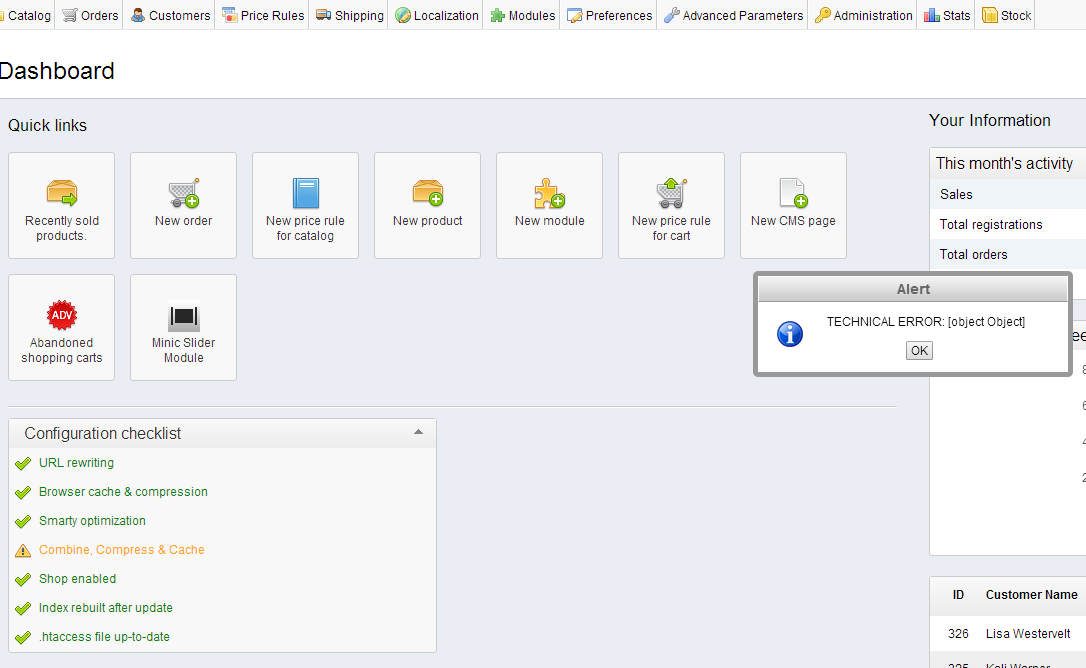

buyiaito Posted September 27, 2016 Share Posted September 27, 2016 (edited) My prestashop is 1.5.6.1 version, when I log in back office, and click any button (for example: click orders), the page will return to "log in page", repeat and repeat, it is very headache, I can't do anything in backoffice, list item, process order etc I don't know what problem it is, hope prestashop expert, or any person met same problem can help me. thank you ! Edited September 27, 2016 by buyiaito (see edit history) Link to comment Share on other sites More sharing options...
