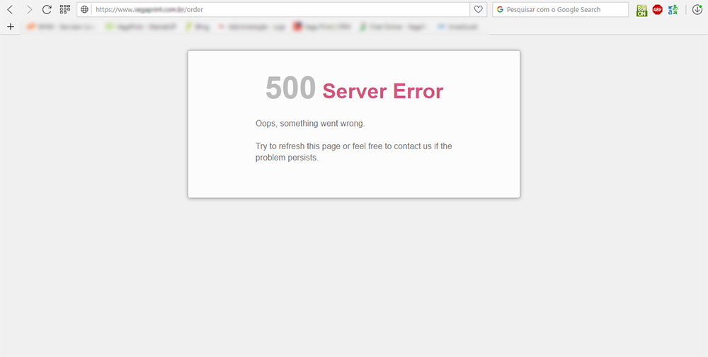

Guest Vega Networks Posted September 10, 2016 Share Posted September 10, 2016 (edited) Minha versão do Prestashop é 1.6.1.6 e eu estava utilizando o modulo do Mercado Pago na versão 3.2.2, e estava normal, após eu remover ele e instalar a versão 3.3.6 e coloca-lo em funcionamento, minha loja quando vai para sessão de pagamento (/order) recebo erro 500... alguém sabe o que pode estar ocorrendo??? -------------- My version of PrestaShop is 1.6.1.6 and I was using the Paid Market module in version 3.2.2 , and was normal after I remove it and install the 3.3.6 version and puts it into operation , my shop when going to payment session ( / order ) I get error 500 ... does anyone know what might be happening ??? Edited September 10, 2016 by vegabusiness (see edit history) Link to comment Share on other sites More sharing options...
rocky Posted September 10, 2016 Share Posted September 10, 2016 Edit config/defines.inc.php and change the value of _PS_DEV_MODE_ from false to true and you should get a more specific error message that should help you to debug the issue. You can also try contacting the developer of the module for support. Link to comment Share on other sites More sharing options...
Guest Vega Networks Posted September 10, 2016 Share Posted September 10, 2016 Edit config/defines.inc.php and change the value of _PS_DEV_MODE_ from false to true and you should get a more specific error message that should help you to debug the issue. You can also try contacting the developer of the module for support. Hi Rocky, thank you for me to answer ... below is the error information to appear in the part where I get the error 500 ( noting that this only happens when I click to go to the final payment ) It was all normal, it worked without any problem the store payments, but an hour for another stop ,after presenting the first problem , I changed the module on the other , and the problem persists , I changed the payment module of another company, and the problem also persists , one thing that I find important to mention is that when trying to make the payment with the module native prestashop for bank transfer the problem does not happen.Another thing , the same day that detected the problem , I did the integration of PrestaShop to our ERP , and the integration was done via webservice , I'm mentioning it because it was the only thing I did differently in PrestaShop before detecting the problem. .. I await your help, and if you need any other information , just ask me , hug,have a great weekend... (Oi Rocky, muito obrigado por me responder... segue abaixo as informações de erro que aparecem na parte onde recebo o erro 500 (lembrando que isso só ocorre quando clico para ir ao pagamento definitivo) Estava tudo normal, funcionava sem nenhum problema os pagamentos da loja, mas de uma hora pra outra parou, depois que apresentou o primeiro problema, troquei o modulo por outro, e o problema persiste, troquei pelo modulo de pagamento de outra empresa, e o problema também persiste, uma coisa que acho importante mencionar, é que ao tentar efetuar o pagamento com o modulo nativo do prestashop para transferência bancaria o problema não acontece. Outra coisa, no mesmo dia que detectei o problema, eu fiz a integração do Prestashop ao nosso ERP, e a integração foi feita via Webservice, estou mencionando isso pois isso foi a única coisa que fiz de diferente no Prestashop antes de detectar o problema... Aguardo sua ajuda, e caso precise de qualquer outra informação, é só me solicitar, abraço, tenha um ótimo final de semana...) Below error message appears after you turn the mode "DEV": Notice: Use of undefined constant _PS_CLOUDFLARE_SSL - assumed '_PS_CLOUDFLARE_SSL' in /home/vegaprintcom/public_html/classes/Tools.php on line 411 Warning: Cannot modify header information - headers already sent by (output started at /home/vegaprintcom/public_html/classes/Tools.php:411) in/home/vegaprintcom/public_html/classes/controller/FrontController.php on line 1000 Warning: Cannot modify header information - headers already sent by (output started at /home/vegaprintcom/public_html/classes/Tools.php:411) in/home/vegaprintcom/public_html/classes/controller/FrontController.php on line 1001 Warning: Cannot modify header information - headers already sent by (output started at /home/vegaprintcom/public_html/classes/Tools.php:411) in/home/vegaprintcom/public_html/classes/exception/PrestaShopException.php on line 37 [PrestaShopException]Property Customer->document is empty at line 909 in file classes/ObjectModel.php 904. }905. 906. $message = $this->validateField($field, $this->$field); 907. if ($message !== true) { 908. if ($die) { 909. throw new PrestaShopException($message); 910. } 911. return $error_return ? $message : false; 912. } 913. } 914. ObjectModelCore->validateFields - [line 246 - classes/ObjectModel.php] ObjectModelCore->getFields - [line 47 - modules/gerencianet/controllers/front/payment.php] GerencianetPaymentModuleFrontController->initContent - [line 189 - classes/controller/Controller.php] ControllerCore->run - [line 367 - classes/Dispatcher.php] DispatcherCore->dispatch - [line 28 - index.php] Link to comment Share on other sites More sharing options...
rocky Posted September 11, 2016 Share Posted September 11, 2016 My guess is that you disabled a module, but its overrides are continuing to run. The default Customer class doesn't have a document field, so a module must have added it. I suggest that you look for override/classes/Customer.php, maybe try renaming it so it doesn't run anymore. It's probably best to check all your overrides and rename any that belong to a module you are no longer using. Link to comment Share on other sites More sharing options...

Guest Vega Networks Posted September 11, 2016 Share Posted September 11, 2016 My guess is that you disabled a module, but its overrides are continuing to run. The default Customer class doesn't have a document field, so a module must have added it. I suggest that you look for override/classes/Customer.php, maybe try renaming it so it doesn't run anymore. It's probably best to check all your overrides and rename any that belong to a module you are no longer using. Hello Rocky, I renamed the file as you suggested me , and it worked, the store went out of the 500 error and could make the regular payment. Important information : In Custumers.php file only had information about a module that use to add the CPF field ( unique identification number here in Brazil ) the registration form from the store,even now I disabled it too , I'll send down what is within my Custumers.php file ... can take a quick look and tell me if you see something unusual in him, I wanted to understand the problem , because I need these fields on my form you see? Thank you in advance ! File content Custumer.php: <?php class Customer extends CustomerCore { /* * module: cpfuser * date: 2016-09-01 21:25:45 * version: 1.6 */ public $document; /* * module: cpfuser * date: 2016-09-01 21:25:45 * version: 1.6 */ public $rg_ie; /* * module: cpfuser * date: 2016-09-01 21:25:45 * version: 1.6 */ public $doc_type; /* * module: cpfuser * date: 2016-09-01 21:25:45 * version: 1.6 */ public function __construct($id = null, $id_lang = null, $id_shop = null) { $definition = self::$definition; $definition['fields']['document'] = array('type' => ObjectModelCore::TYPE_STRING, 'required' => true); $definition['fields']['rg_ie'] = array('type' => ObjectModelCore::TYPE_STRING); $definition['fields']['doc_type'] = array('type' => ObjectModelCore::TYPE_INT, 'required' => true); self::$definition = $definition; parent::__construct($id, $id_lang, $id_shop); } } Thanks!!!!!!!!!!! Link to comment Share on other sites More sharing options...

rocky Posted September 13, 2016 Share Posted September 13, 2016 The problem is that 'document' and 'doc_type' are required, so every time code that is unaware of this tries to save a customer object without those fields, there is a Fatal Error. Link to comment Share on other sites More sharing options...
