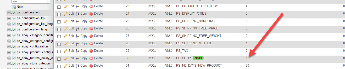

imugur Posted October 23, 2016 Share Posted October 23, 2016 Store is in maintenance mode and I don't know how to make it live without back office access. Link to comment Share on other sites More sharing options...
jetway Posted October 23, 2016 Share Posted October 23, 2016 if you have access to the database you can enable it from there. in the ps_configuration table there is a value called PS_SHOP_ENABLED, its set to 0 in your case, that value needs to be changed to 1. But again, if anybody tries this, please be very careful when going into databases. (see attachment) Link to comment Share on other sites More sharing options...

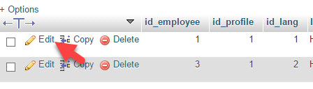

jetway Posted October 23, 2016 Share Posted October 23, 2016 (edited) if you go into ps_employee do you see your admin account? Edited October 23, 2016 by jetway (see edit history) Link to comment Share on other sites More sharing options...
imugur Posted October 23, 2016 Share Posted October 23, 2016 yes, it's there Link to comment Share on other sites More sharing options...
jetway Posted October 23, 2016 Share Posted October 23, 2016 is the value active set to 1? Link to comment Share on other sites More sharing options...
imugur Posted October 23, 2016 Share Posted October 23, 2016 yes Link to comment Share on other sites More sharing options...
jetway Posted October 23, 2016 Share Posted October 23, 2016 (edited) ok well lets try to reset your password in the database and see if that works: (see attachment) Please copy paste the current encrypted password into a file for backup and then Copy the _COOKIE_KEY_ value key into the value field of the password followed by your new password. if you key is 1234567890 then copy that into the value field followed by your password1234567890Testtesttesttest or whatever the function muss be MD5. And save.... Look if you can sign in again. Please see attachments Edited October 23, 2016 by jetway (see edit history) Link to comment Share on other sites More sharing options...
