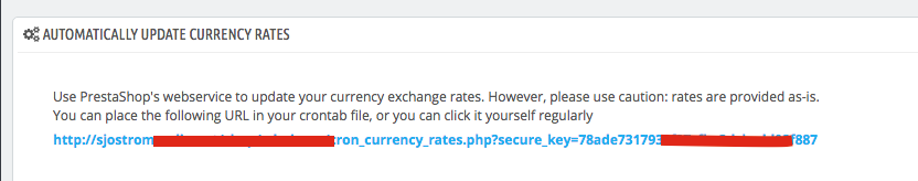

peranders Posted September 11, 2016 Share Posted September 11, 2016 (edited) Have you added "wget" in front of the string? Notice that you must add "wget " in front of the string, at least if you are using cron jobs via cpanel. See attached picture. For me cron jobs works perfectly for updating the currencies Edited September 11, 2016 by peranders (see edit history) Link to comment Share on other sites More sharing options...
