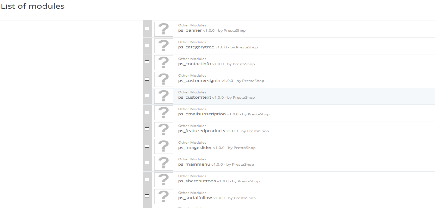

thryciuk Posted September 5, 2016 Share Posted September 5, 2016 Hi, I had the same error today and renamed the module as vekia said to do. In my modules there are some that look odd compared to the other modules. When i click on install it will crash. Please see attached picture. Thanks Trevor Link to comment Share on other sites More sharing options...
Pr3torian Posted September 5, 2016 Author Share Posted September 5, 2016 Hi again! it worked just fine for me to! it was the ps_banner that screwed with me... thanks again for your help Vekia!! //Daniel Link to comment Share on other sites More sharing options...
