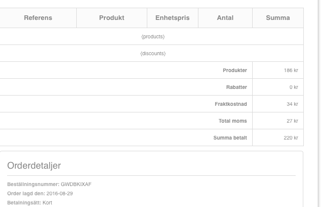

Steppo Posted August 29, 2016 Share Posted August 29, 2016 Hi all, Does anyone know if Email alerts is removed from Prestashop - i can't find it in the theme from the lates version. Thanks in advance! //Stefan Link to comment Share on other sites More sharing options...

Steppo Posted August 29, 2016 Author Share Posted August 29, 2016 (edited) Thanks for reply! I have it installed and Yes you are correct - expressed myself not so well i realize - there are no email templates here (just downloaded lates zip from prestahop.com) Are there not supposed to be there? Cant get the product purchased to show up in the alert mail. Edited August 29, 2016 by Steppo (see edit history) Link to comment Share on other sites More sharing options...

Steppo Posted August 29, 2016 Author Share Posted August 29, 2016 Great - however i have downloaded this before - I did as myselfidem said and downloaded from BO - so actually no need to go to github - will test now and see if mail templates from Github is needed... The initial reason for my questions is that the product are not listed in the mail delivered "new_order.html" as in the image there... Ill keep your posted... Link to comment Share on other sites More sharing options...
myselfidem Posted August 29, 2016 Share Posted August 29, 2016 (edited) Maybe you can check the translated files about "new_order.txt" and "new_order.html" inside your customized theme folder or default theme. ..\themes\your_theme\modules\mailalerts\mails\your language folder Edited August 29, 2016 by myselfidem (see edit history) Link to comment Share on other sites More sharing options...
Steppo Posted August 29, 2016 Author Share Posted August 29, 2016 (edited) Mercy beaucoup Sir for all ideas my friend! All is alive now. I did as you said or in a way recommended. 1. Deleted everything on server and installed from inside Admin or Bo and then all worked as supposed. 2. Now time for designing the template. And for this i will duplicate the "mails" folder in yourshop/modules/mailalerts/ and move this folder to to /yourshop/themes/yourtheme/modules/mailalerts/ The folder "mail alerts" inside you theme´s module folder you will have to create by your self... When done the files in your theme will override the core templates and you will be able to edit the mails design or what ever you'll like. What do you think myselfidem - make sense:) Thanks a bunch// Stefan Edited August 29, 2016 by Steppo (see edit history) 1 Link to comment Share on other sites More sharing options...
