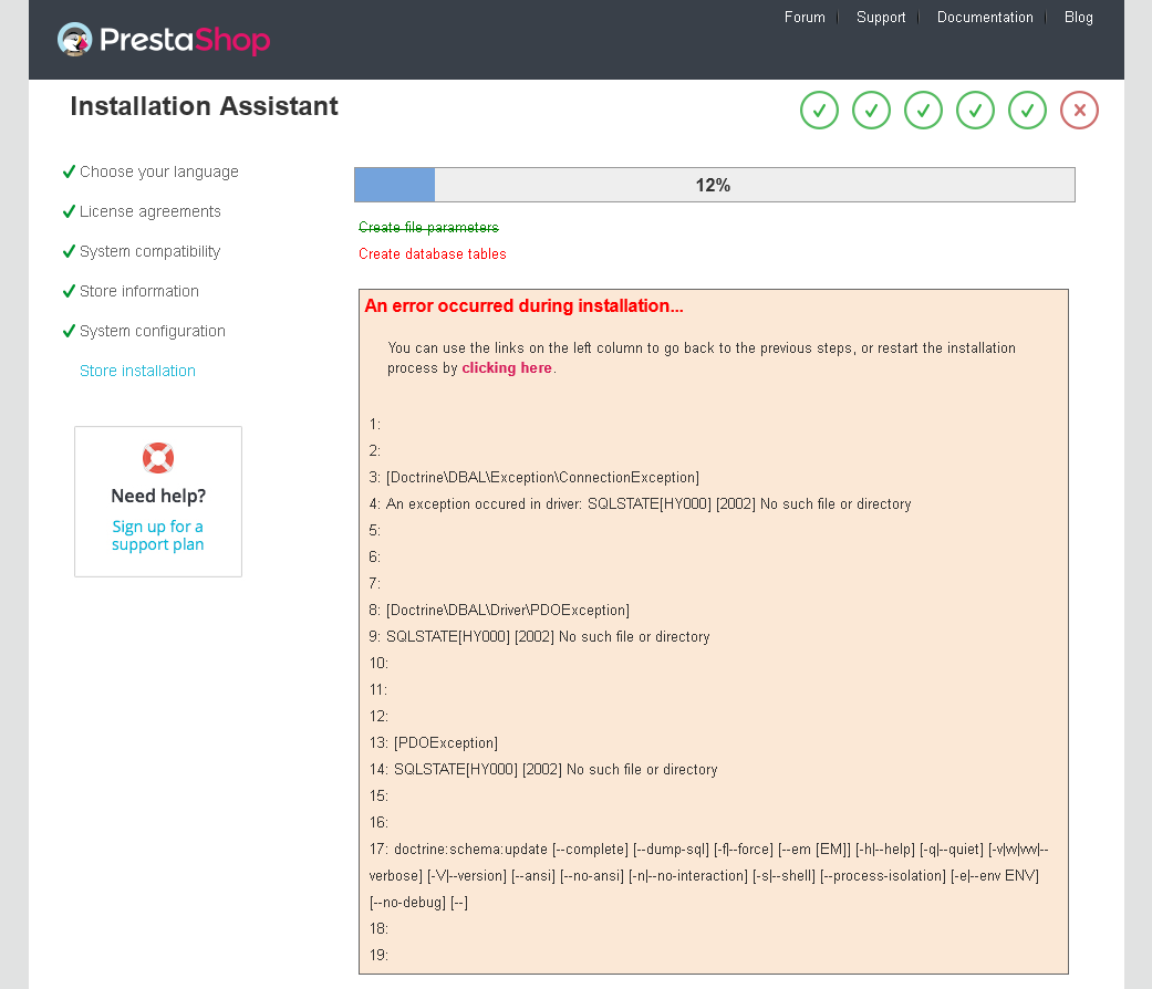

goodish Posted August 15, 2016 Share Posted August 15, 2016 (edited) Clean installation cannot install database tables : Error in attachment Edited August 15, 2016 by goodish (see edit history) Link to comment Share on other sites More sharing options...
vekia Posted August 15, 2016 Share Posted August 15, 2016 - it looks like database user does not exist (?) - what host(db/www) software you use in your environment ? Link to comment Share on other sites More sharing options...

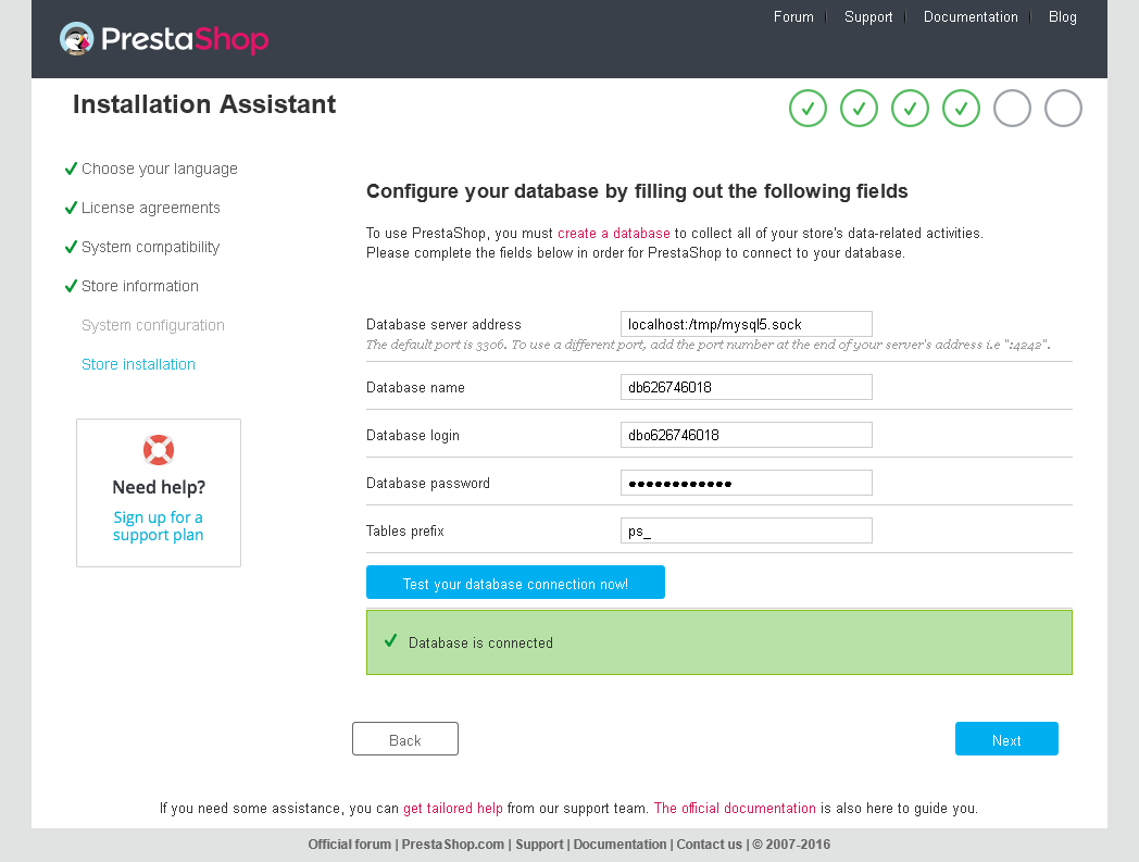

Traumflug Posted August 15, 2016 Share Posted August 15, 2016 Correct. The installer expects a running database server and an existing user. Ideally an empty, but existing database, too. There's even a "Test MySQL connection" button to check this. Link to comment Share on other sites More sharing options...
goodish Posted August 17, 2016 Author Share Posted August 17, 2016 SOLVED The fail was in host server - not work under localhost (socket), I had to change to another host server and instalation was correctly. Link to comment Share on other sites More sharing options...
