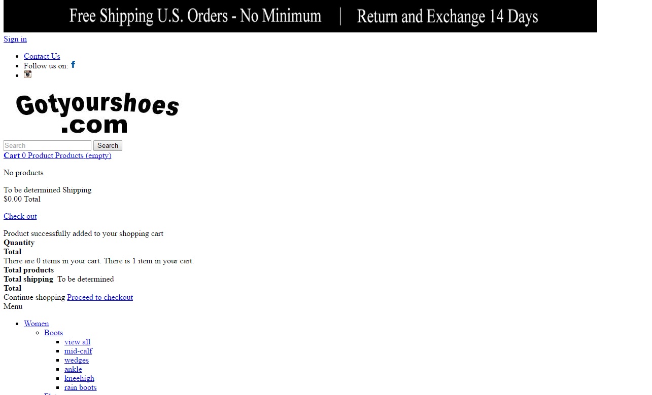

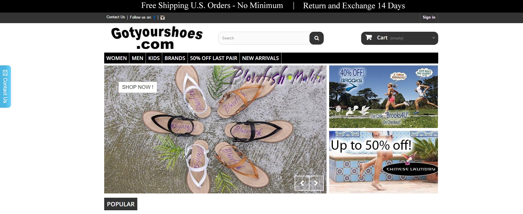

4thbasement Posted August 9, 2016 Share Posted August 9, 2016 Hi all, I've been struggling with this problem for a while so I figured I'd try to get some help again. Any changes made to the website, whether it's modifying a CSS file or simply adding another link to the Horizontal Menu, does not take affect until I clear cache in back office performance. The issue is this: after clearing the cache this is how the home page looks like (image 00). It takes up to 15 minutes for it to fix itself up. Image 00 is how the site usually looks like. All my cache options under performance are turned on, as itdoes seem to work wonders for the site's speed, however, I would sacrifice speed for stability in some of these options are causing this problem. Does anyone have any idea why this happens? I don't believe it was an issue until upgrading prestashop to 1.6. Also, please point me in the right direction if there is list of specific proper instructions on how to deal with making changes in prestashop to avoid these issues. Any help greatly appreciated as always, Thank you Link to comment Share on other sites More sharing options...
