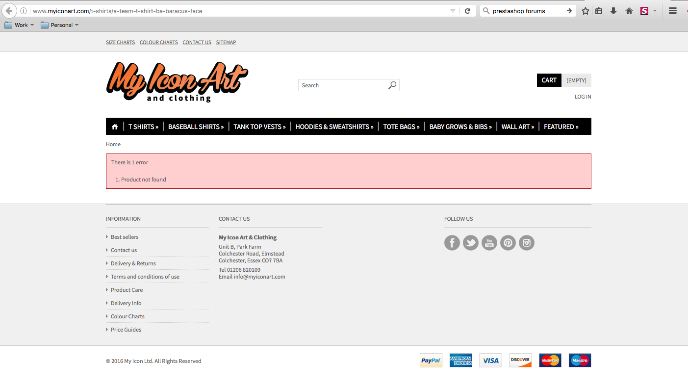

PasiniOnline Posted August 9, 2016 Share Posted August 9, 2016 Hi. Using Prestashop 1.5.6 on Apache. Have finished uploading products and every product appears in the category list but random products return the following error when you try to view them: There is 1 error Product not found There really doesn't seem to be any pattern to it. And about a third of the products seem to be affected. If I manually change the URL through the back end, the products work. But I want to keep the URLs how they are and even so manually changing them is out of the question as I have over 7,000 products. I believe it must be something to do with the Pretty URLs module as when I turn it off, products work but with a URL I don't want to keep. Take a look for yourselves: www.myiconart.com Any help is greatly appreciated. Link to comment Share on other sites More sharing options...

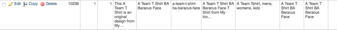

OpenSource Expert Posted August 11, 2016 Share Posted August 11, 2016 Please check your product_lang table column(filed) link_rewrite for products that have product-not-found-error. Please share a URl that shows page not found Link to comment Share on other sites More sharing options...
PasiniOnline Posted August 12, 2016 Author Share Posted August 12, 2016 Hi thanks for your reply. I attach two images: • A screenshot of product_lang table which shows the link_rewrite • A screenshot of the product in the front of house which shows it is missing. Only difference is the category is added in the shop. Would getting rid of that help? Link to comment Share on other sites More sharing options...
vekia Posted August 15, 2016 Share Posted August 15, 2016 you use some module that removes id from links the problem you've got is with the module you use it just doesnt work well. Link to comment Share on other sites More sharing options...
