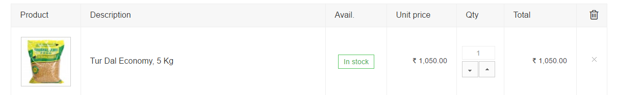

bilusunny Posted August 8, 2016 Share Posted August 8, 2016 I need to have the products manufacturer name added in the order page as well. Please see the screenshot where it says description and has the product name, I need a column for the manufacturer name as well. Please assist! Link to comment Share on other sites More sharing options...
