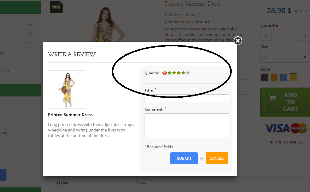

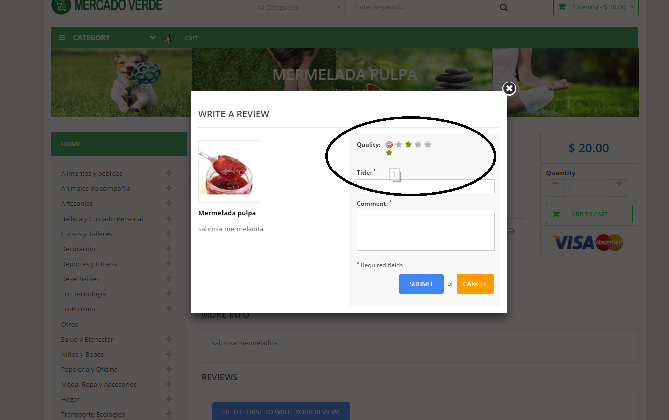

MercadoVerde Posted August 4, 2016 Share Posted August 4, 2016 (edited) Good day, I hope your help, I'm bad for prestashop, I recently installed the module Product Comments v3.5.2 in my prestashop 1.6.1.6 but gives me an error at the stars, I hope can help me. I attached some pictures. Thanks a lot. this is the site https://www.mercadoverde.com.mx/mvp-v1.0/index.php an image is looks like my page and the other as should see it Edited August 5, 2016 by MercadoVerde (see edit history) Link to comment Share on other sites More sharing options...

MercadoVerde Posted August 4, 2016 Author Share Posted August 4, 2016 Thanks for responding so fast. I understand what you're saying, but the problem is not in the red button. The problem is in the stars, they are accommodated in the wrong way, in my shop the star appears below the red button and the demo works fine. Also in the form of qualify and that the star will fill. You can see in the images, thank you very much for answering, greetings. Link to comment Share on other sites More sharing options...
OpenSource Expert Posted August 5, 2016 Share Posted August 5, 2016 The issue may be css. Your main CSS is overriding the module CSS. It is possible that the module may not exist in your site Or you have disabled it. Try to activate it so that you get correct display. Link to comment Share on other sites More sharing options...
MercadoVerde Posted August 5, 2016 Author Share Posted August 5, 2016 Thank you very much, I already fixed it, I leave the solution in case happens to someone else. in themes/default-bootstrap/js/global.js find lines: if (typeof bindUniform !=='undefined') bindUniform(); and comment it: // if (typeof bindUniform !=='undefined') // bindUniform(); Tks Link to comment Share on other sites More sharing options...
