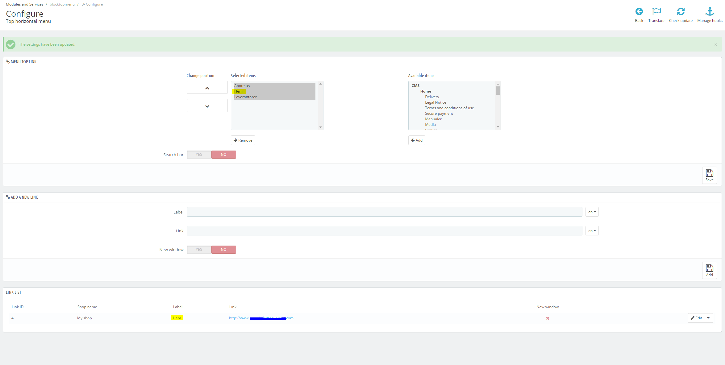

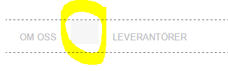

When I try and create a new link (custom) it wont show the link title I've choosen for it. It will only be a white box appearing as you can see on the pictures attached.

Actual Menu:
Config:
Thank you in advance!
I actually solved this myself now. Sometimes you just want to pat yourself on your shoulder, think I will do this now.
So what I did was:
Logged on to my database, there I could see that when I created a custom link, it would create 2 entries, 1 containing the Label + Link information, the other not.
Since my primary language is not English no information is entered for that but only for English.
I then run the following to change this and now it appears for my native language:
UPDATE `6797prestashop_linksmenutop_lang` SET `id_lang` = 2 WHERE `id_lang` = 1
