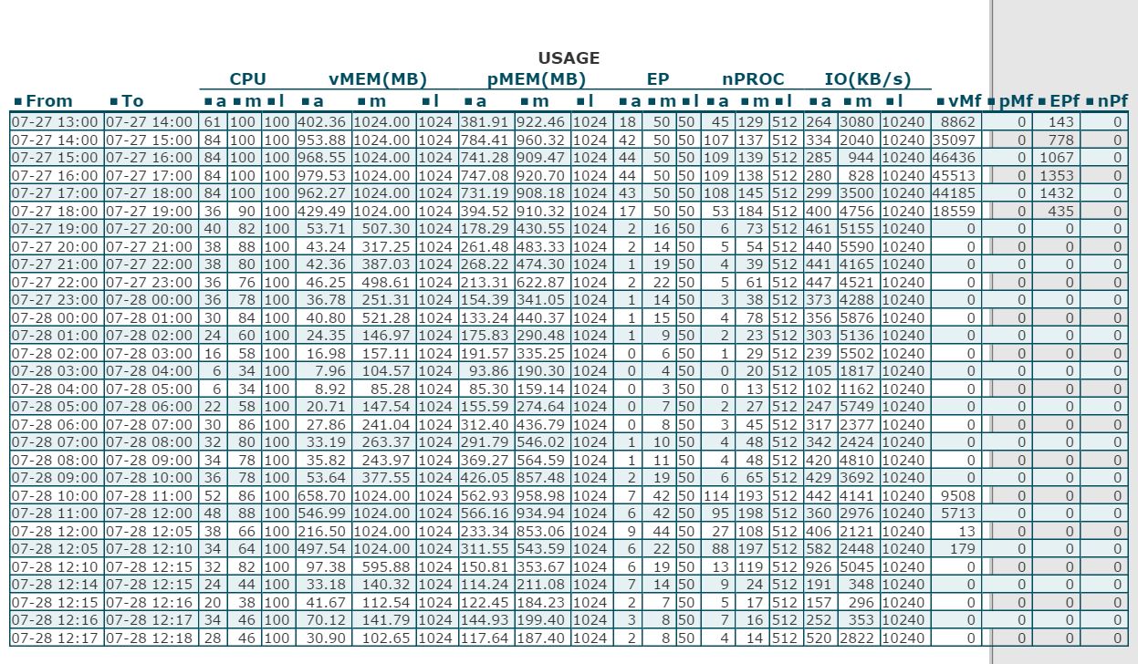

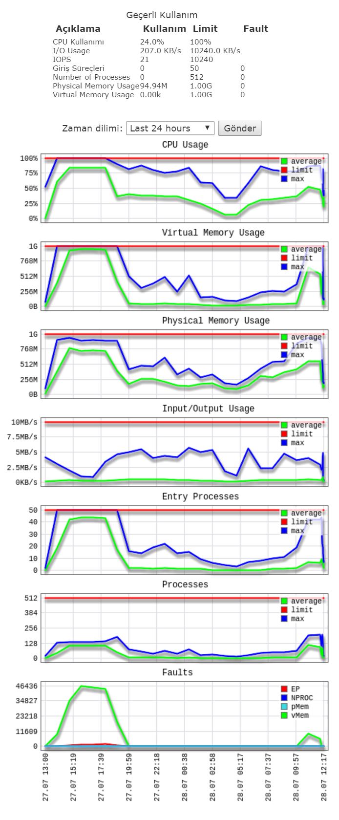

sonkaya Posted July 28, 2016 Share Posted July 28, 2016 Hello, My page address is sonkaya.com.tr (using Presta v1.6.09) Novadays the apache server blocks the page and I researched and find some information about it. Can you check the attached image files and tell me how can I solve the cpu and vmem and entry process limit problem. The table shows vmem faults and entry process fautls as you see. Many thanks. ------ Error_log [27-Jul-2016 12:11:03 UTC] PHP Fatal error: Out of memory (allocated 3145728) (tried to allocate 237 bytes) in /public_html/classes/db/DbPDO.php on line 91[27-Jul-2016 12:11:27 UTC] PHP Fatal error: Out of memory (allocated 5767168) (tried to allocate 17920 bytes) in /public_html/tools/htmlpurifier/HTMLPurifier.standalone.php on line 17902[27-Jul-2016 15:13:29 Europe/Istanbul] PHP Fatal error: Out of memory (allocated 19660800) (tried to allocate 80 bytes) in /public_html/classes/cache/CacheFs.php on line 70[27-Jul-2016 12:15:14 UTC] PHP Fatal error: Out of memory (allocated 2883584) (tried to allocate 3072 bytes) in /public_html/classes/Theme.php on line 220 Link to comment Share on other sites More sharing options...
bellini13 Posted July 28, 2016 Share Posted July 28, 2016 What is the max_memory you have defined for each php process. According to these errors, it is a very small number. Link to comment Share on other sites More sharing options...

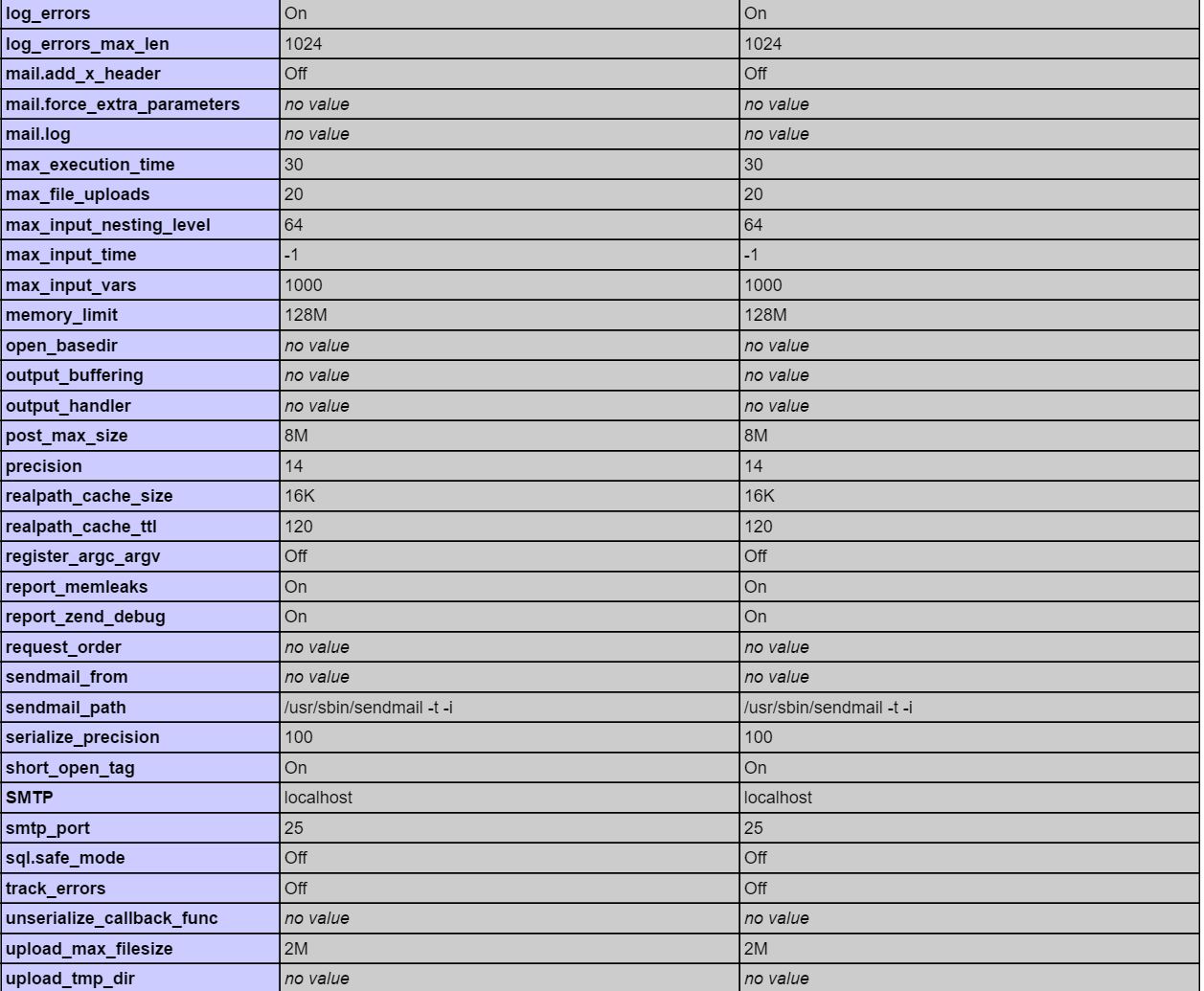

sonkaya Posted July 28, 2016 Author Share Posted July 28, 2016 Hi Bellini13, This is shared server. I didnt define any value. I just chekced php info and it says memroy_limit=128M( you can see the attached image files at the first topic) Thanks. Link to comment Share on other sites More sharing options...
