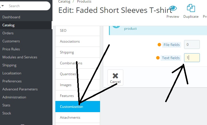

musicmaster Posted July 21, 2016 Share Posted July 21, 2016 (edited) My suggestion would be to use the customization fields of products. If you add a customization text field it will be a free text field and it will appear in the tabs of your product page, but both those issues can be solved with some modifications in your product.tpl file. Edited July 21, 2016 by musicmaster (see edit history) Link to comment Share on other sites More sharing options...

musicmaster Posted July 21, 2016 Share Posted July 21, 2016 Sure, you cannot set prices. I don't have a solution for that. As for the modifications. I don't know any cookbook article, but it isn't that difficult. You should modify the file product.tpl of your theme. Inside the file you should find the text "customization" and replace the code for the input field with a selectbox with certain product id's. On my theme the relevant code that should be replaced looks as follows: {if $product->text_fields|intval} <div class="customizableProductsText"> <h3>{l s='Text'}</h3> <ul id="text_fields"> {counter start=0 assign='customizationField'} {foreach from=$customizationFields item='field' name='customizationFields'} {if $field.type == 1} <li class="customizationUploadLine{if $field.required} required{/if}"> <label for ="textField{$customizationField}">{assign var='key' value='textFields_'|cat:$product->id|cat:'_'|cat:$field.id_customization_field} {if !empty($field.name)}{$field.name}{/if}{if $field.required}<sup>*</sup>{/if}</label> <textarea name="textField{$field.id_customization_field}" id="textField{$customizationField}" rows="1" cols="40" class="customization_block_input">{if isset($textFields.$key)}{$textFields.$key|stripslashes}{/if}</textarea> </li> {counter} {/if} {/foreach} </ul> </div> {/if} The syntax of the templates of Smarty. Smarty has extensive documentation on the internet. Link to comment Share on other sites More sharing options...
