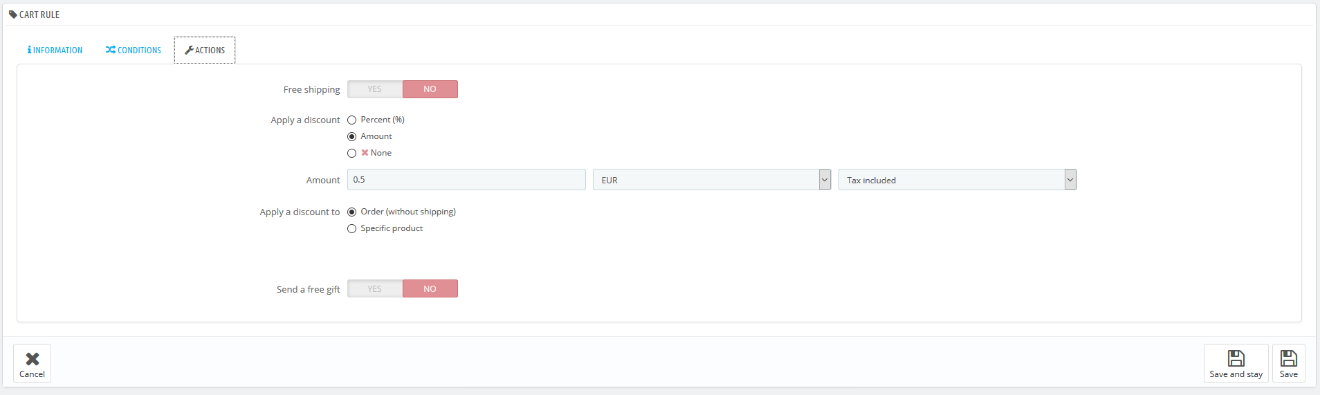

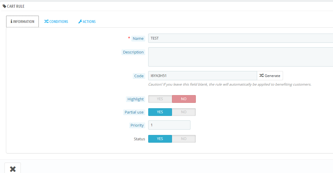

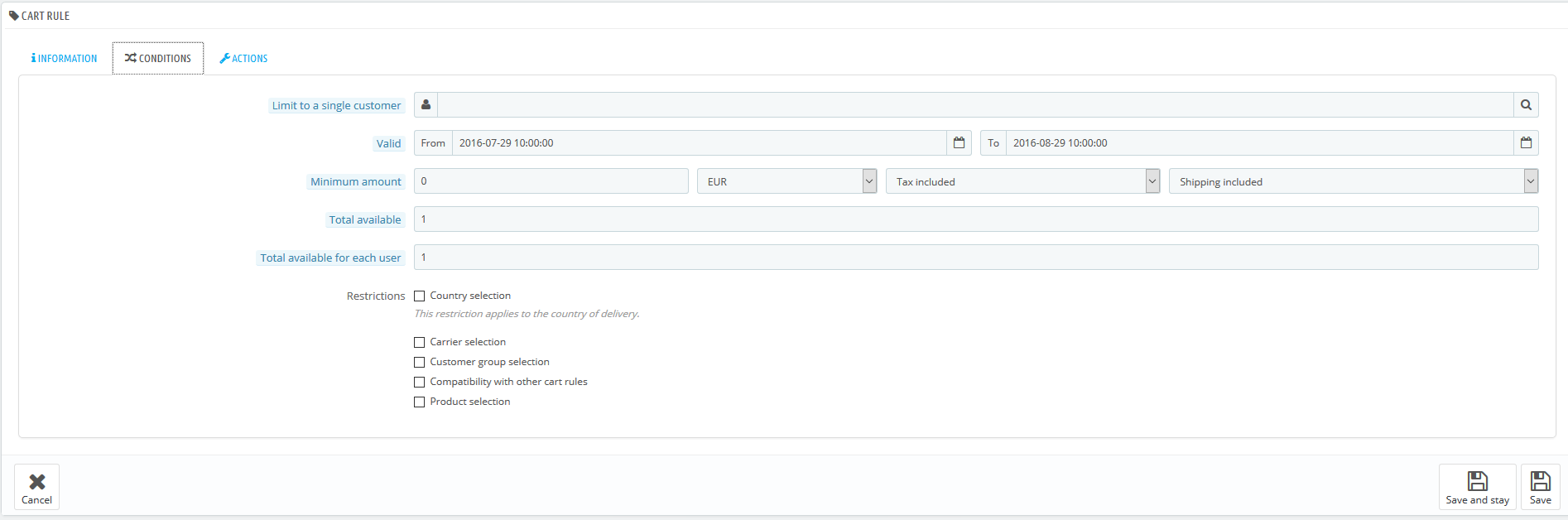

Smiles Posted July 29, 2016 Share Posted July 29, 2016 I have the same issue after update to 1.6.1.6! What happens in my case is that SOME made cart rules are visable for customers. While the setting is highlight is not selected. Still all customers can see this discount in there account overview. The only difference is that it is not allocated to a certain person. But in earlier version not allocated cart rules where not shown in user accounts.... Did you slove this issue? In the attachement the settings of a cart rule which shows in everyonce account... Link to comment Share on other sites More sharing options...
