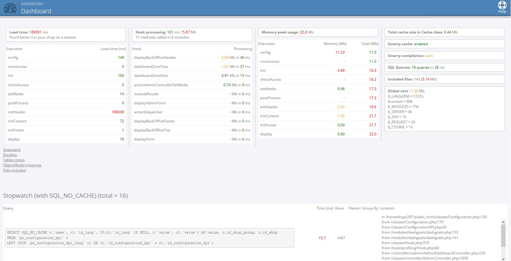

giovanz47 Posted July 6, 2016 Author Share Posted July 6, 2016 Hi, After enabling profiling, it came up with this: Load Time init 189194 I'm assuming this is the issue, but how can i fix it? Link to comment Share on other sites More sharing options...
musicmaster Posted July 6, 2016 Share Posted July 6, 2016 Below that overview you will find the times for the individual queries. You should check there which query is so slow. Link to comment Share on other sites More sharing options...

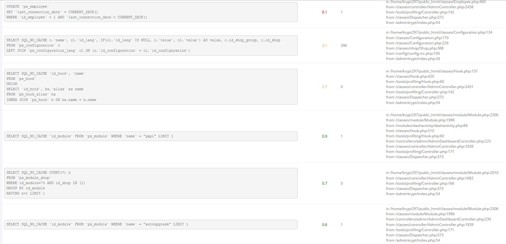

giovanz47 Posted July 6, 2016 Author Share Posted July 6, 2016 Below that overview you will find the times for the individual queries. You should check there which query is so slow. musicmaster the slowest query is only 25.9ms, could it be something else? Link to comment Share on other sites More sharing options...
JPresta.com Posted July 6, 2016 Share Posted July 6, 2016 Can you do a screen shot so we can see more? Link to comment Share on other sites More sharing options...
giovanz47 Posted July 6, 2016 Author Share Posted July 6, 2016 Screenshots attached Link to comment Share on other sites More sharing options...
JPresta.com Posted July 6, 2016 Share Posted July 6, 2016 Ok, so problem is in a module hooked in displayBackOfficeHeader. Check modules that are hooked here, try to disable one by one and see if it's better. Link to comment Share on other sites More sharing options...

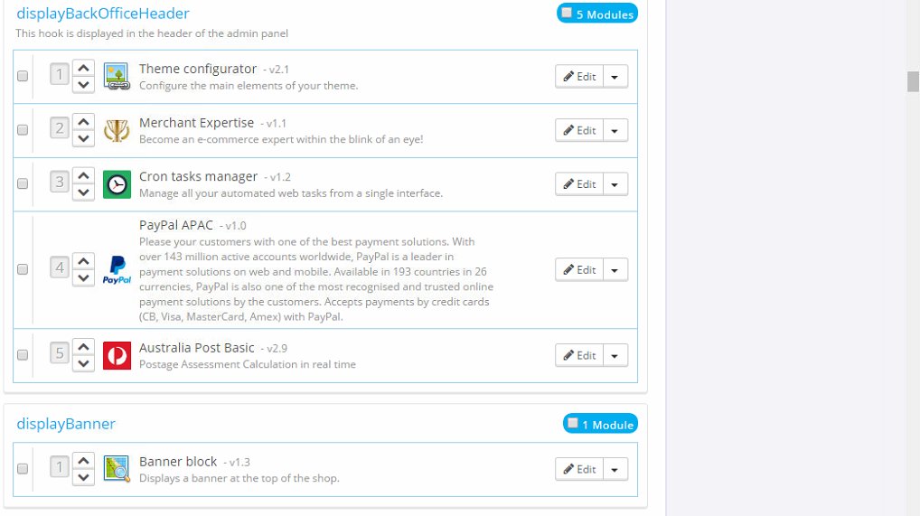

giovanz47 Posted July 7, 2016 Author Share Posted July 7, 2016 Sorry can you explain how I can find the list of modules that are hooked in displayBackOfficeHeader? Link to comment Share on other sites More sharing options...
musicmaster Posted July 7, 2016 Share Posted July 7, 2016 Sorry can you explain how I can find the list of modules that are hooked in displayBackOfficeHeader? Modules->Positions in the backoffice Link to comment Share on other sites More sharing options...

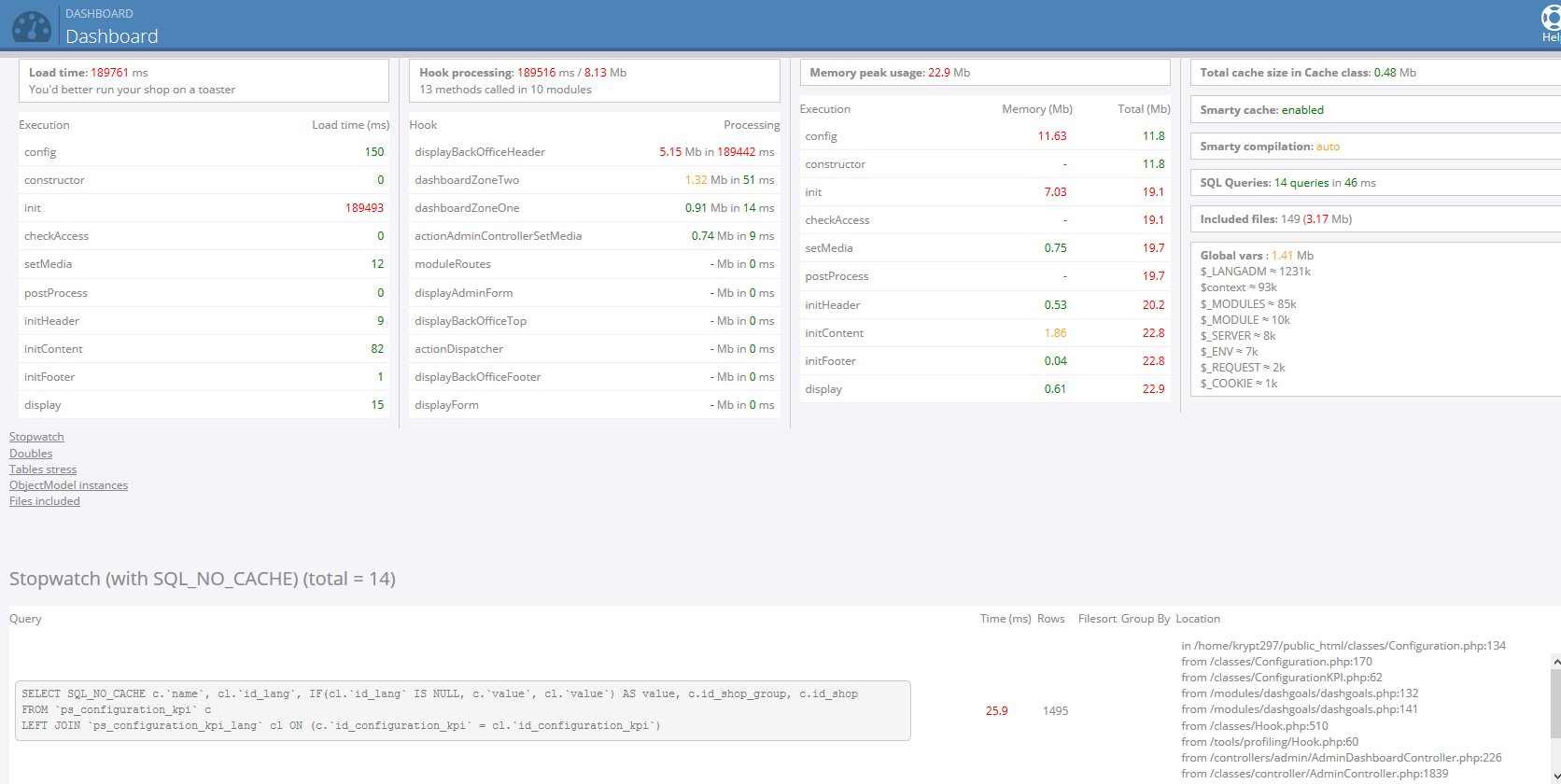

giovanz47 Posted July 8, 2016 Author Share Posted July 8, 2016 Thanks for that. I went through and disabled the 5 modules but didn't notice any changes so I re-enabled the PayPal as I definitely need this one. After unhooking Australia Post Basic module, I now have issues with initHeader. i have attached screenshots. Thanks. Link to comment Share on other sites More sharing options...
giovanz47 Posted July 8, 2016 Author Share Posted July 8, 2016 Just an update, I decided to completely uninstall the Australia Post Basic module as I am not currently using it and now everything seems to be running ok. Can anyone explain why this issue occurred? It's been installed and enabled for a long time and never had a problem. Link to comment Share on other sites More sharing options...
musicmaster Posted July 8, 2016 Share Posted July 8, 2016 Just an update, I decided to completely uninstall the Australia Post Basic module as I am not currently using it and now everything seems to be running ok. Can anyone explain why this issue occurred? It's been installed and enabled for a long time and never had a problem. One option is that it needed to download some info from the Australia Post domain and that that became suddenly slow. That could be because of problems at their side. It could also be that some security software (anti-virus, anti-spam, etc) at your side suddenly started to make trouble. Link to comment Share on other sites More sharing options...
