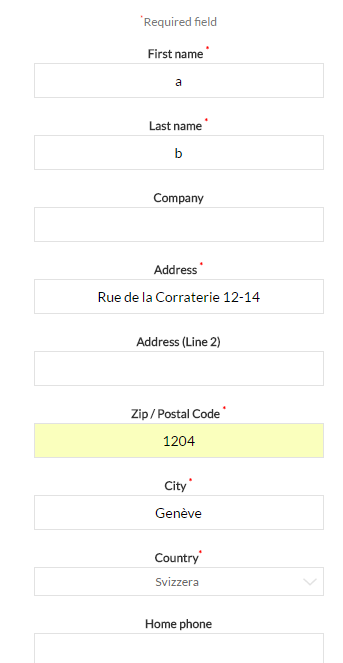

Graphics Back Label Posted July 12, 2016 Author Share Posted July 12, 2016 I tried to take a look, it seems the issue is not on every page, I guess it is only on payment selection page. I tried a few products, they are out of stock and finally got one and signed up a test account and get to the payment selection page, but everything seems fine. I see your test account lol Anyway, can you try to register like a swiss? Try with this account address: Rue de la Corraterie 12-14,1204 Genève,Svizzera I can't see the postcode never "green" with this address.. in normal registration and on the checkout too.. Link to comment Share on other sites More sharing options...

Graphics Back Label Posted July 12, 2016 Author Share Posted July 12, 2016 I just tried on My Account - Addresses page and it seems working fine. Please look at this new screenshot, can you see the issue? Link to comment Share on other sites More sharing options...
shokinro Posted July 12, 2016 Share Posted July 12, 2016 I do not see this validation error mark (icon). I guess it might be related to your browser, I used Chrome, and when I tried to use FireFox, your store stopped working. No response now. 1 Link to comment Share on other sites More sharing options...

shokinro Posted July 14, 2016 Share Posted July 14, 2016 You can see screen image here, there is no error - when click "save" button, it will save the address without any errors. Link to comment Share on other sites More sharing options...
