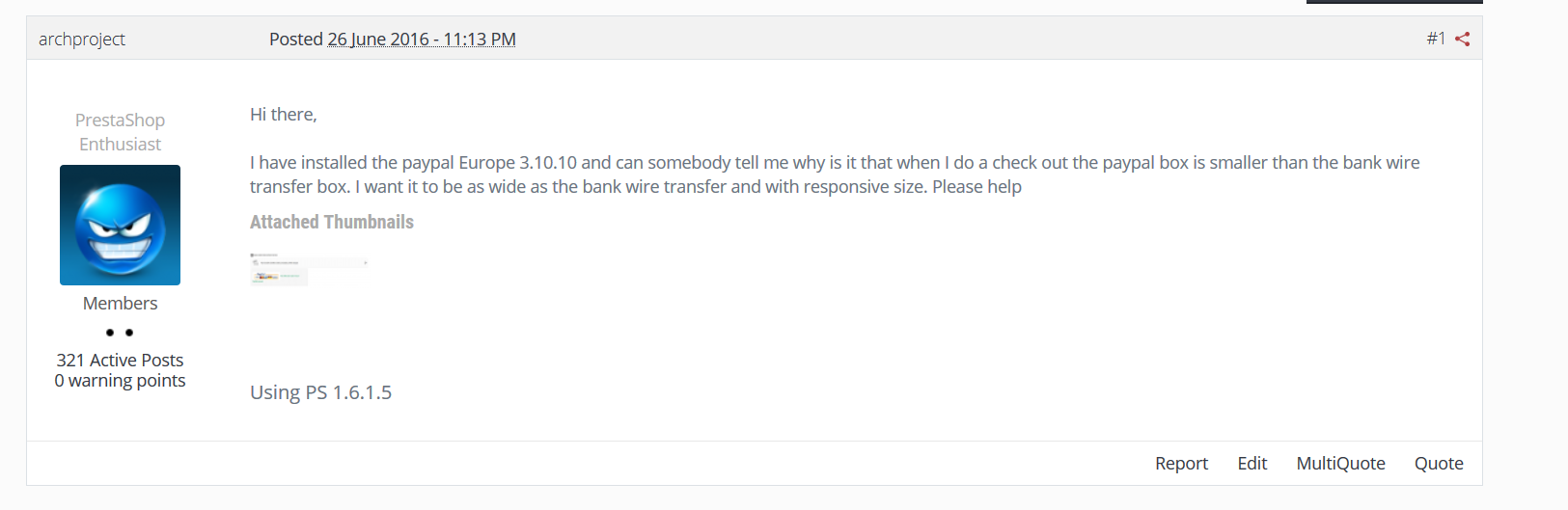

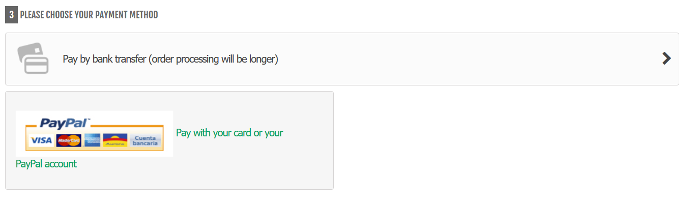

archproject Posted June 26, 2016 Share Posted June 26, 2016 Hi there, I have installed the paypal Europe 3.10.10 and can somebody tell me why is it that when I do a check out the paypal box is smaller than the bank wire transfer box. I want it to be as wide as the bank wire transfer and with responsive size. Please help Link to comment Share on other sites More sharing options...
Rolige Posted June 26, 2016 Share Posted June 26, 2016 Edit the file /modules/paypal/views/templates/hook/express_checkout_payment.tpl Around the line 29, change this <div class="col-xs-12 col-md-6"> To this <div class="col-xs-12"> Clear cache! 1 Link to comment Share on other sites More sharing options...
archproject Posted June 26, 2016 Author Share Posted June 26, 2016 Great ... works like a charm thank you very much Link to comment Share on other sites More sharing options...
