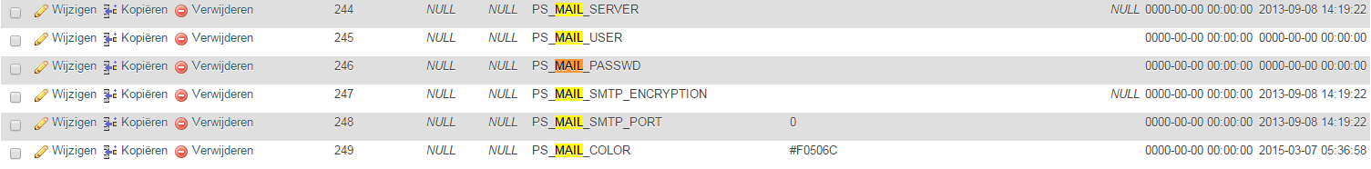

Edit: Did some futher digging, I found these database fields which seem to be empty, are they supposed to be:

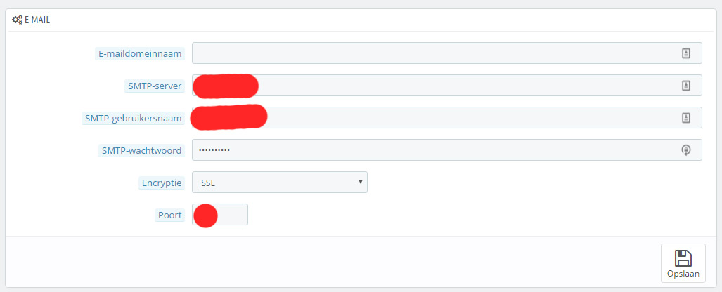

I have them filled out in the backoffice, but I can't seem to update them either (after saving the page resets and it shows the old configuration):
