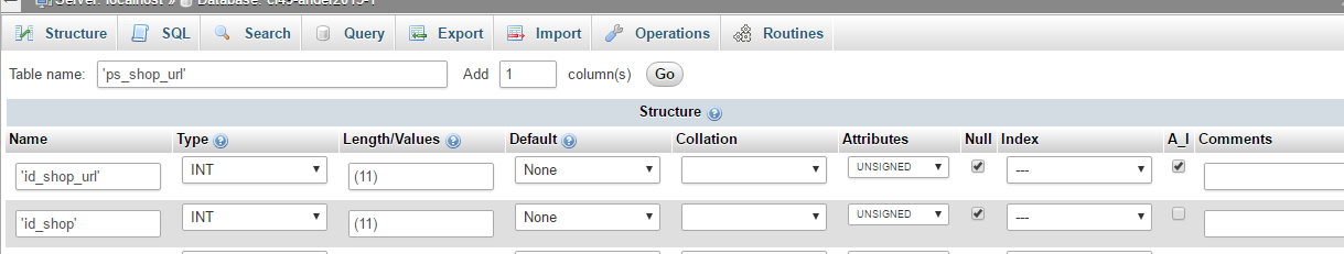

Barry1975 Posted June 20, 2016 Author Share Posted June 20, 2016 Hi, Many thanks, I really do appreciate it. I think I am putting it in correctly, see attached PNG, though it has been years and years since I have tackled anything in PHPMYAdmin Link to comment Share on other sites More sharing options...
Barry1975 Posted June 20, 2016 Author Share Posted June 20, 2016 Thanks, I did this, the error code now displays Table 'cl49-ander2013-1.ps_shop' doesn't exist Link to comment Share on other sites More sharing options...
