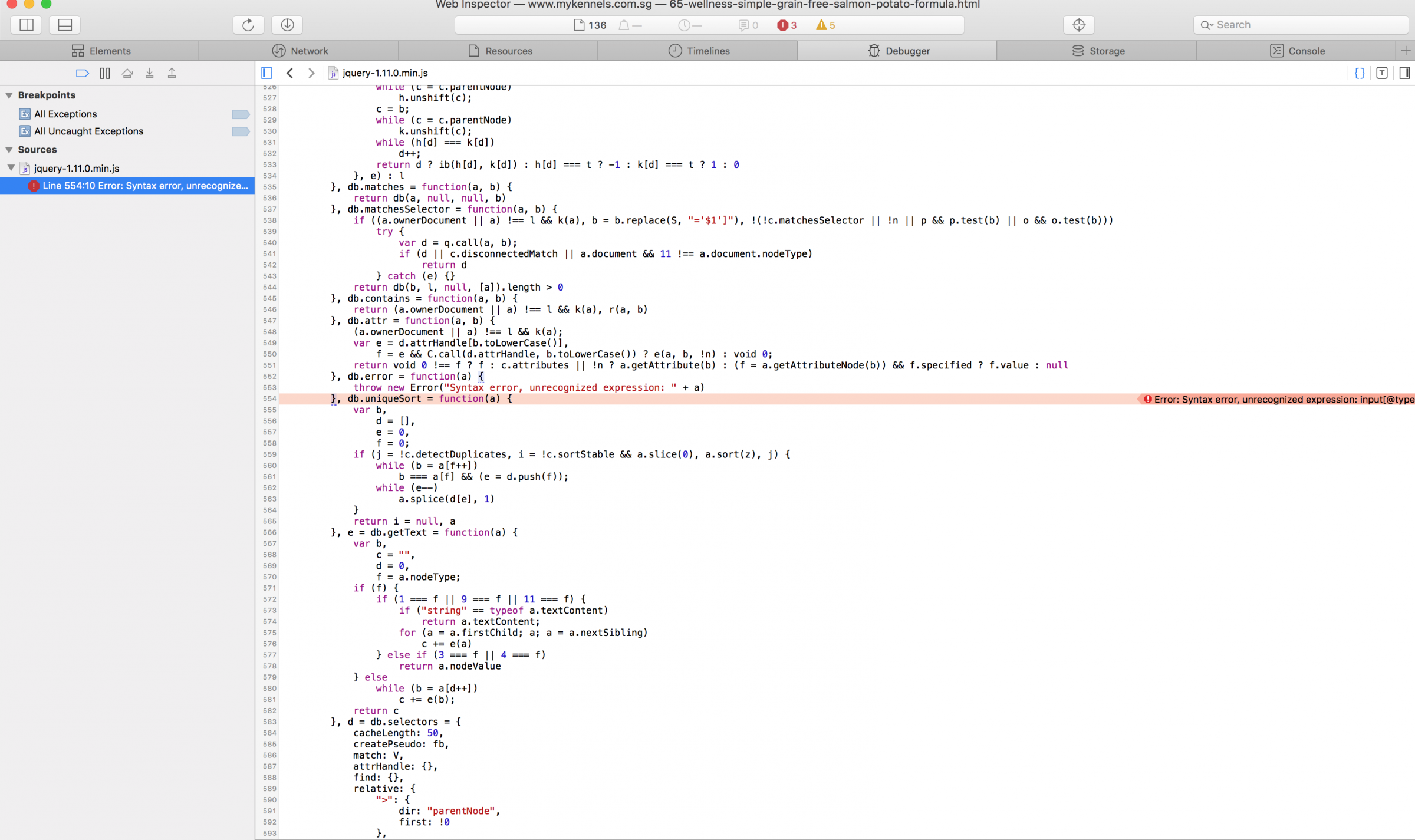

shokinro Posted June 5, 2016 Share Posted June 5, 2016 You can use browser debug tool to see there is any javascript errors. - Go to the page where you see problem - Press F12, a new debug tool window will show up - Go Console tab, you will see javascript errors if there is any Link to comment Share on other sites More sharing options...
lionel seow Posted June 6, 2016 Author Share Posted June 6, 2016 thanks and i have follow your instruction and these are what its shows. the funny thing is all these items use to work in the version before this current upgrade.... so how can i solve it? Link to comment Share on other sites More sharing options...
shokinro Posted June 6, 2016 Share Posted June 6, 2016 it is jquery library, usually it should not be a problem. I guess there is something not updated correctly during your upgrade. The error was cut off, we are not able to see the full error message. Link to comment Share on other sites More sharing options...

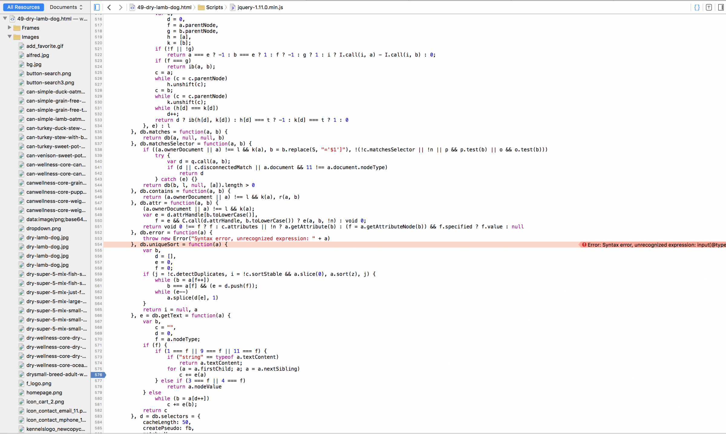

lionel seow Posted June 6, 2016 Author Share Posted June 6, 2016 combination show price all key in correctly. but web don't show up. this items was running fine in the old version. but this current one is giving me this issue! making me headache Link to comment Share on other sites More sharing options...
lionel seow Posted June 6, 2016 Author Share Posted June 6, 2016 Link to comment Share on other sites More sharing options...
