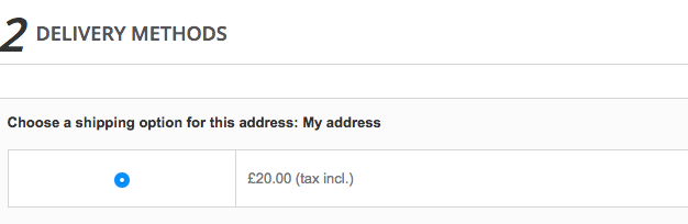

akps1234 Posted May 15, 2016 Share Posted May 15, 2016 (edited) Hi there, After recently upgrading the PS version from 1.6.1.4 to 1.6.1.5 I found out that there is an extra ghost carrier named "null" with "Free" shipping that appears in the "Carrier List" table below the available registered Carriers. It shows up only in Step 1 "Shopping-Cart Summary" page of 5-step Order Checkout, and not in page Step 4 "Shipping" See the print screen below. Does anybody know how to get rid of this unwanted option? Thank you, Alex Edited May 15, 2016 by akps1234 (see edit history) Link to comment Share on other sites More sharing options...

andrew Posted October 24, 2017 Share Posted October 24, 2017 Hi we are also having similar - its when we have products which can not be shipped using certain carriers (rather than coming up with no carrier - it looks like this) Would you say it was the same thing? It also happened after updating to 1.6.1.5 (from 1.5 - where all was OK) Was it only the database you restored - or some code too? (maybe i can compare the difference) Link to comment Share on other sites More sharing options...
