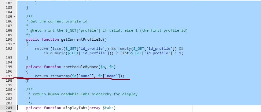

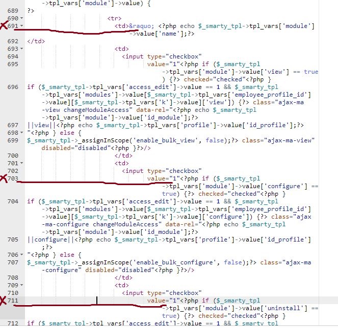

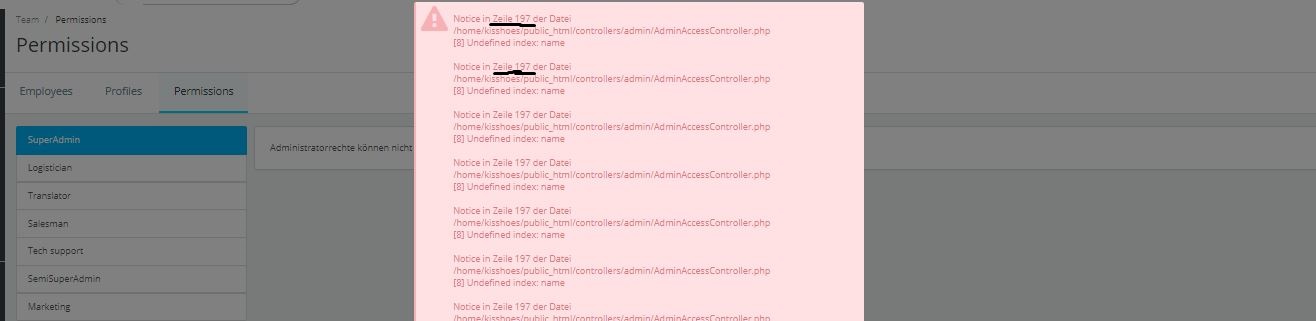

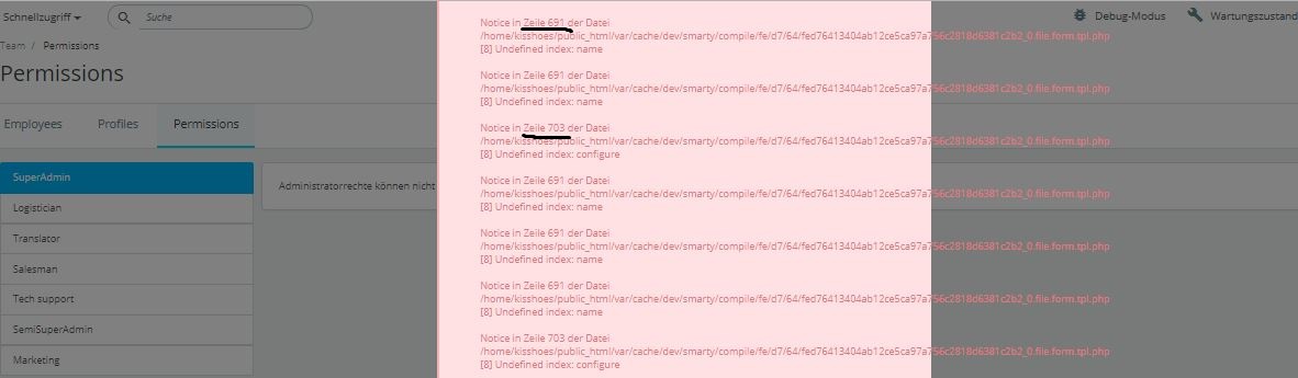

sbempire Posted September 3, 2018 Share Posted September 3, 2018 I lost access to all my modules, I can no longer configure them, with this error message " You are not authorized to configure a module" This issue started after I removed my ps-access table and replaced it with a clean ps-access DB as I had problem accessing my orders and stats menu. This action solved the issue I had with orders and stats menu, however, it caused issues to configure my modules In the images are more details of the issues. Please does somebody has any explanation for these errors? Thank you for your help in advance Link to comment Share on other sites More sharing options...
lullaby11 Posted December 12, 2018 Share Posted December 12, 2018 On 9/3/2018 at 4:09 PM, sbempire said: I lost access to all my modules, I can no longer configure them, with this error message " You are not authorized to configure a module" This issue started after I removed my ps-access table and replaced it with a clean ps-access DB as I had problem accessing my orders and stats menu. This action solved the issue I had with orders and stats menu, however, it caused issues to configure my modules In the images are more details of the issues. Please does somebody has any explanation for these errors? Thank you for your help in advance Expand Did you find a solution for this? Im stuck at that point too Link to comment Share on other sites More sharing options...
