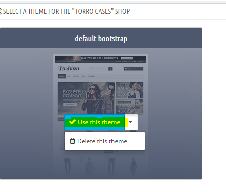

joetorro Posted April 29, 2016 Share Posted April 29, 2016 Hi, Background I'm using Prestashop 1.6.1.5 with the Leo Fashion Theme. All I have done since I've had issues is update maintenance.tpl, disable the cache, as well as delete the theme's cache. I'm currently in maintenance mode. After that, I started having issues with "Leo bootstrap megamenu", a module used in the Leo Fashion theme (this is a separate issue). I decided to uninstall the theme completely so I could reinstall and hopefully resolve this. The Problem The weird thing is that the "Use this theme" button does nothing now. I click it and the loading wheel turns for a while before the page updates, but nothing happens; the theme doesn't change. Any ideas? Thanks, Joe Link to comment Share on other sites More sharing options...
shokinro Posted April 29, 2016 Share Posted April 29, 2016 use client (browser) debugger tool to see if there any javascrpt error occurring. you can Press F12 key to start browser debugger tool and then go to Console tab, you will see errors if there is any. that might give you some hints. Link to comment Share on other sites More sharing options...
joetorro Posted April 29, 2016 Author Share Posted April 29, 2016 Thanks shokinro, No errors in the console I'm afraid... Link to comment Share on other sites More sharing options...
shokinro Posted April 29, 2016 Share Posted April 29, 2016 I guess you may have to switch back to default theme first before deleting the other theme. when you delete the other theme, PS has automatically switched back to the default theme already, that's why you are not able to click "Use this theme"? you may try to install other theme back and then try again the "use this theme" on default theme again to see if it works, Link to comment Share on other sites More sharing options...
joetorro Posted May 3, 2016 Author Share Posted May 3, 2016 Thanks Shokinro, I'll try that and post how I get on. Joe Link to comment Share on other sites More sharing options...
joetorro Posted May 3, 2016 Author Share Posted May 3, 2016 Actually, this isn't possible. The current theme is definitely the Leo Fashion theme. So, if I delete this theme there will be no theme..? Thanks, Joe Link to comment Share on other sites More sharing options...
shokinro Posted May 3, 2016 Share Posted May 3, 2016 you said you have deleted it before? now sure how you deleted it. it is better switch to other themes first and then delete it. Link to comment Share on other sites More sharing options...
shokinro Posted May 3, 2016 Share Posted May 3, 2016 you can try. after delete that theme, please make sure the theme was set back to default theme. you can check that in following tables ps_shop (id_theme column) ps_themes (theme you have installed) Link to comment Share on other sites More sharing options...
