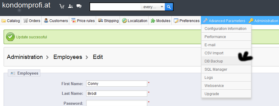

selectshop.at Posted April 25, 2016 Share Posted April 25, 2016 A cannot figure out, what you are trying to do. To fix crashed tables on database you should use a specific program on your server. As I'm not fan of phpMyAdmin, I use Heidi-SQL for to maintain databases. There you have the possibility to search for broken tables and fix them at once. Also in Prestashop 1.5. there is an option for to save database, if you are trying to make a back-up. You will find it on tab: advanced parameters -> DB back-up. For to avoid that the file is getting big, it will be automatically saved into the format zip. The 12-click-upgrader is also saving db in zip format, which is not big. So I don't understand what is going wrong on your server. gzip not installed, proper configured ? Link to comment Share on other sites More sharing options...
