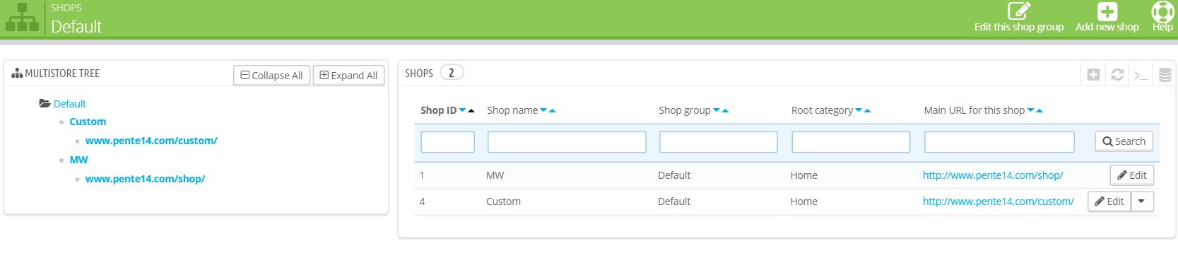

Pente14 Posted April 20, 2016 Share Posted April 20, 2016 I want to add additional shop within the current store. I have the default which is www.pente14.com/shop/ I have added a second called Custom I set the domain as www.pente14.com/custom/ The documentation says .... "Do not create any subdomain or subfolder yourself, either on your server or your computer: PrestaShop takes care of creating the path for you on your server. When the customer requests this path, PrestaShop will recognize the shop and serve the files and data for the correct store automatically." However, when I save the information I cannot see the new area for this shop And the browser of course can't find it. How do I make the final step in setting up this new shop? Many thanks Steve Link to comment Share on other sites More sharing options...

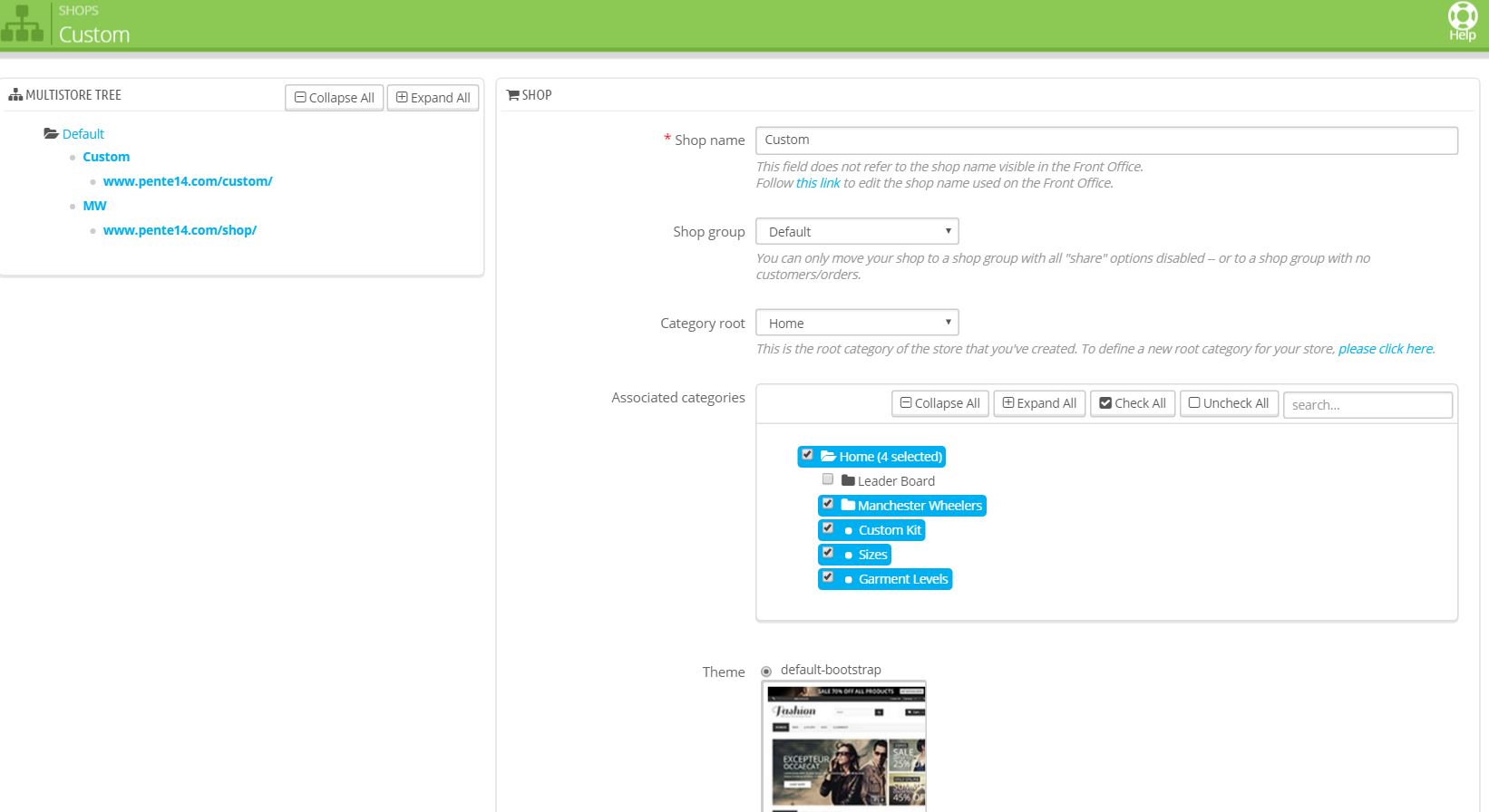

Pente14 Posted April 21, 2016 Author Share Posted April 21, 2016 Shokinro Many thanks for taking the time to reply I had set all the switches, associated the categories Are you using PrestaShop original multistore feature? Make sure you have enabled this feature at back office - Preference - General. Once multistore is enabled, you will see additional menu appears under Advanced Parameters - Multistore You can create shop from there. After the shop is created, then you can specify the URL of the shop. Check Prestaashop user guide related part for more details. Thank you for your help I am using the standard Prestashop facilities from v1,6 I have already set all of the parameters. Do I have to create the required directory and install any files? Link to comment Share on other sites More sharing options...

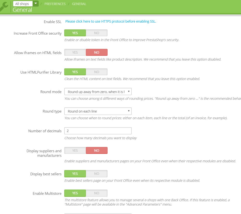

Pente14 Posted April 22, 2016 Author Share Posted April 22, 2016 if you want create a separated PrestaShop store, you can just install under its any sub-folder. but it will be completely different store with different database. If you want to use mutistotre feature, then you will need enable multistore feature. you not need install a separated files or folders. it will be virtual directory - virtual URL. Once again thanks for your help However, I want the multistore feature but it is not activating. It is enabled. I have configured the advanced parameters. The new shop is showing in the tree. No URL or directory has been generated Link to comment Share on other sites More sharing options...

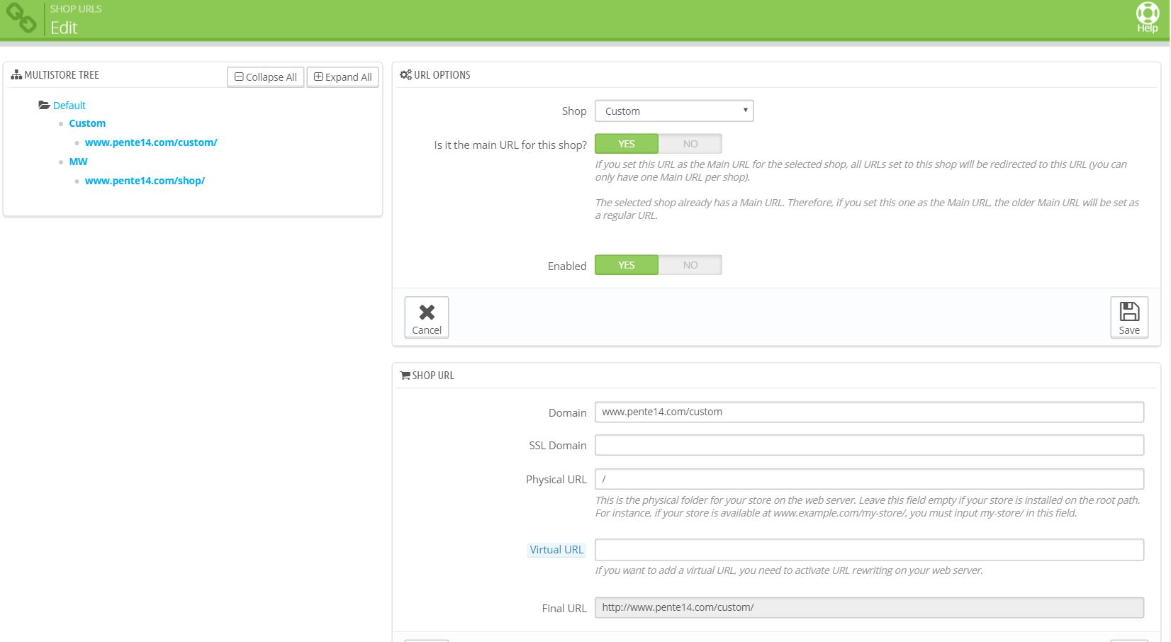

Pente14 Posted April 22, 2016 Author Share Posted April 22, 2016 (edited) I have set the parameters but the URL or directories aren't showing The following are the settings Can anyone advise? Edited April 22, 2016 by Pente14 (see edit history) Link to comment Share on other sites More sharing options...
shokinro Posted April 22, 2016 Share Posted April 22, 2016 As mentioned previously, there will be no additional physical folder created for each URL. The URL is a virtual URL such http://pente14.com/custom/ http://pente14.com/shop/ ... From your screenshot images, I see the the URLs are already there? Link to comment Share on other sites More sharing options...
Pente14 Posted April 22, 2016 Author Share Posted April 22, 2016 As mentioned previously, there will be no additional physical folder created for each URL. The URL is a virtual URL such http://pente14.com/custom/ http://pente14.com/shop/ ... From your screenshot images, I see the the URLs are already there? You are being very patient with me .. thank you If the URL is there why does the browser say address not found. And where is the URL .. I can't see it? I am betraying my stupidity, I guess Link to comment Share on other sites More sharing options...
shokinro Posted April 22, 2016 Share Posted April 22, 2016 If you enter the URL which is defined for the shop but you got 404 - not found error, then I guess the .htaccess is not generated correctly. You can try to switch SEO friendly URL off and back to on to trigger the regenerate of the .htaccess to see if it helps. Link to comment Share on other sites More sharing options...
shokinro Posted April 22, 2016 Share Posted April 22, 2016 Also I just noticed one thing: It seems that the http://pente14.com/shops/ is your main store (prestashop) URL, your other stores URL should under this main store, Something like http://pente14.com/shop/custom/. Link to comment Share on other sites More sharing options...

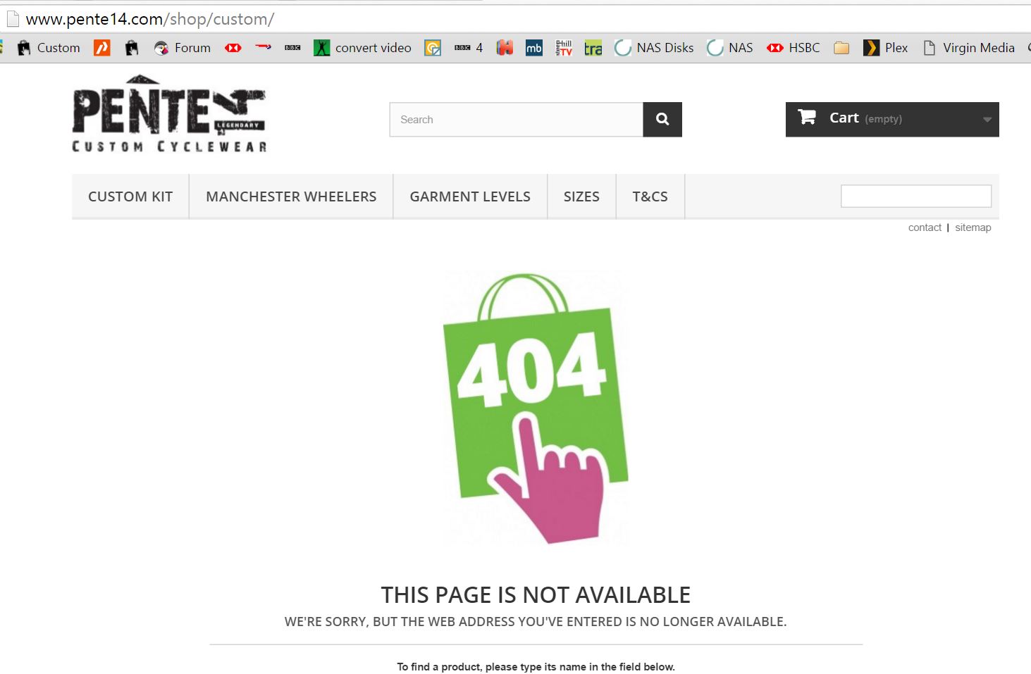

Pente14 Posted April 22, 2016 Author Share Posted April 22, 2016 Also I just noticed one thing:It seems that the http://pente14.com/shops/ is your main store (prestashop) URL, your other stores URL should under this main store, Something like http://pente14.com/shop/custom/. Hi It's getting better But now getting a 404 error on the default page of the Custom page of www.pente14.com/shop/custom ..... Any thoughts? Once again, I am very grateful for your support Link to comment Share on other sites More sharing options...

shokinro Posted April 23, 2016 Share Posted April 23, 2016 (edited) thank @EI Patron for inducing our module. @Pente14 I checked your .htaccess file contents you posted, the following line is really strange, there are multiple "prestaaShop" in the rewrite rules. It should not have, I guess you did not configure the store URL correctly. RewriteRule ^custom$ /prestashop/prestashop/prestashop/custom/ [L,R] I think it is physical uri filed is not done correctly. By the way, we have a module that is for multiple seller/vendor marketplace environment, it will create virtual shop for seller automatically, you do not have to configure them one by one. the URL will be the way you wanted use virtual URL instead of different domain(sub-domain). You may consider to use our modules to implement your requirements. - agile multiple seller module - agile multiple shop module Note - Our modules does not require PresatShop original multi-store store feature. Edited April 23, 2016 by shokinro (see edit history) Link to comment Share on other sites More sharing options...

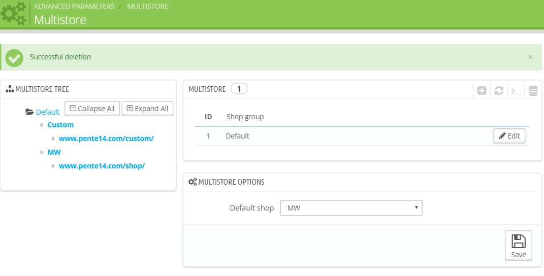

Pente14 Posted April 28, 2016 Author Share Posted April 28, 2016 @EI Patron, thanks for the follow-up, I was also thinking of paste the same user guide URL. @Pente14, hope you will figure out the problem. El Patron, on 23 Apr 2016 - 01:57 AM, said: Hi I deleted the old hsaccess file, cleared cashe, turned off Multistore and started again A new hsaccess files was created. But the 404 message is continuing to appear I looked at the add-on options Are both the multi-seller and multi-shop apps required? :-( Link to comment Share on other sites More sharing options...
shokinro Posted April 28, 2016 Share Posted April 28, 2016 I deleted the old hsaccess file, cleared cashe, turned off Multistore and started again A new hsaccess files was created. But the 404 message is continuing to appear That's really strange. I do not have any idea what could be the cause. By the way, is other pages like Product page (SEO friendly) url works? I looked at the add-on options Are both the multi-seller and multi-shop apps required? Yes, you will need both module. The multiple seller module turns PrestaShop into a multiple seller/vendor marketplace. It does not have virtual shop function. The multiple shop module will allow each seller to have virtual shop with different virtual directory as URL. Link to comment Share on other sites More sharing options...
