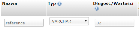

Daresh Posted May 3, 2016 Share Posted May 3, 2016 The Numeric Reference module changes the reference field in orders table to VARCHAR(32) to fit all the prefixes etc. Link to comment Share on other sites More sharing options...
Walrus Posted May 3, 2016 Author Share Posted May 3, 2016 OK...how can I revert table or safely delete it? Prefer not to load backup SQL, which is NOT up to date, or accesible right now. Link to comment Share on other sites More sharing options...
Daresh Posted May 3, 2016 Share Posted May 3, 2016 Restoring backup is not necessary, just go to your PHPMyAdmin and there in the `orders` table structure, edit the `reference` field and change length from 32 to 9. Link to comment Share on other sites More sharing options...
Walrus Posted May 4, 2016 Author Share Posted May 4, 2016 I changed 'Length/Values' 32 to 9 and clicked Save but still order not validating. Link to comment Share on other sites More sharing options...
Daresh Posted May 4, 2016 Share Posted May 4, 2016 So it must be something else there, this module shoud not affect the order validation, it does only one simple thing - generates a different reference, and I don't think that reference is something that gets validated. Link to comment Share on other sites More sharing options...
Walrus Posted May 11, 2016 Author Share Posted May 11, 2016 Not sure what that something else could be. I had deactivated the module, so had concluded it cannot be the module. However, when I uninstalled it, the issue was resolved instantly. Link to comment Share on other sites More sharing options...
