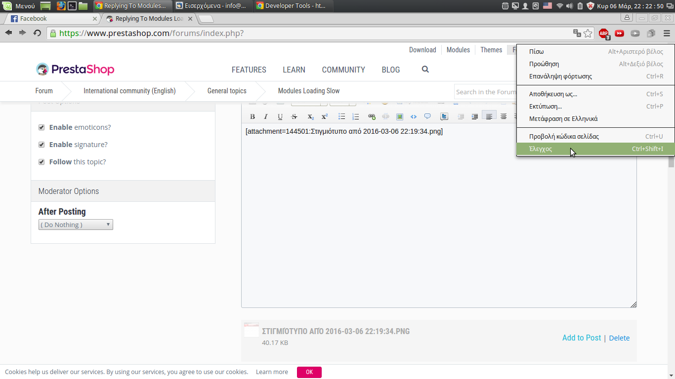

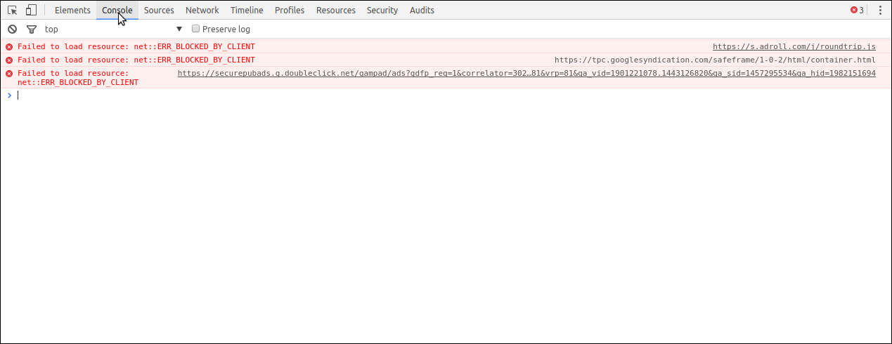

Kogkalidis Posted March 6, 2016 Share Posted March 6, 2016 Help no 1 1. Right Click -> Last element of the menu (in greek is "Check") [Google Chrome]I've heard also about a Firefox addon named "Firebug" and "Network" tab where you can check execution time of every single file that is being called by the server (trying to figure out how it works) 2. "Console" tab in Google Chrome (where you can view errors if any)=== Help no 2 presta installation /config/defines.inc.php -> line 28 if (!defined('_PS_MODE_DEV_')) { define('_PS_MODE_DEV_', false); } Change false to true and saveThis way any errors that occur show in your browser window Link to comment Share on other sites More sharing options...

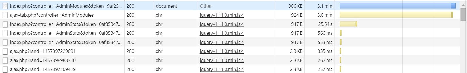

flyclothing Posted March 8, 2016 Author Share Posted March 8, 2016 I ran the firebug and found what is causing it to load so slow but not sure how to fix it. I know my template creator turned off the Prestashop callbacks at one time and that sped it up 90%. Link to comment Share on other sites More sharing options...
