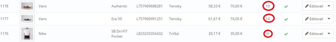

Rissinko Posted March 4, 2016 Share Posted March 4, 2016 Hi I have question about updating tables in database ... I have script which change quantity in database. But there is problem ... if my product has combinations it update all quantity in combinations but quantity in ps_product is not change.. Is there in presta some function which can update this number ? or any sql trigger ? or something like this ? In attachment is picture of quatities that i need to update. Here is the code what Iam using to update my quantities from file : try { $res4 = $db->prepare("SELECT id_product, id_product_attribute from "._DB_PREFIX_."product_attribute WHERE reference = :reference"); $res4->execute(array(':reference'=>$reference)); if ($res4->rowCount() > 0) { $row4 = $res4->fetch(); $res = $db->prepare("update "._DB_PREFIX_."stock_available set quantity = :q where id_product_attribute = :id_product_attribute"); $res->execute(array(':q'=>$quantity, ':id_product_attribute'=>$row4['id_product_attribute'])); $res = $db->prepare("update "._DB_PREFIX_."product_attribute set quantity = :q where id_product_attribute = :id_product_attribute"); $res->execute(array(':q'=>$quantity, ':id_product_attribute'=>$row4['id_product_attribute'])); $res = $db->prepare("update "._DB_PREFIX_."stock_available set quantity = quantity + :q where id_product = :id_product and id_product_attribute = 0"); $res->execute(array(':q'=>$quantity, ':id_product'=>$row4['id_product'])); $res = $db->prepare("update "._DB_PREFIX_."product set quantity = quantity + :q where id_product = :id_product"); $res->execute(array(':q'=>$quantity, ':id_product'=>$row4['id_product'])); } else { // IT'S A SIMPLE PRODUCT $res4 = $db->prepare("SELECT id_product from "._DB_PREFIX_."product WHERE reference = :reference"); $res4->execute(array(':reference'=>$reference)); if ($res4->rowCount() > 0) { $row4 = $res4->fetch(); $res = $db->prepare("update "._DB_PREFIX_."stock_available set quantity = :q where id_product = :id_product and id_product_attribute = 0"); $res->execute(array(':q'=>$quantity, ':id_product'=>$row4['id_product'])); $res = $db->prepare("update "._DB_PREFIX_."product set quantity = :q where id_product = :id_product"); $res->execute(array(':q'=>$quantity, ':id_product'=>$row4['id_product'])); } } Link to comment Share on other sites More sharing options...

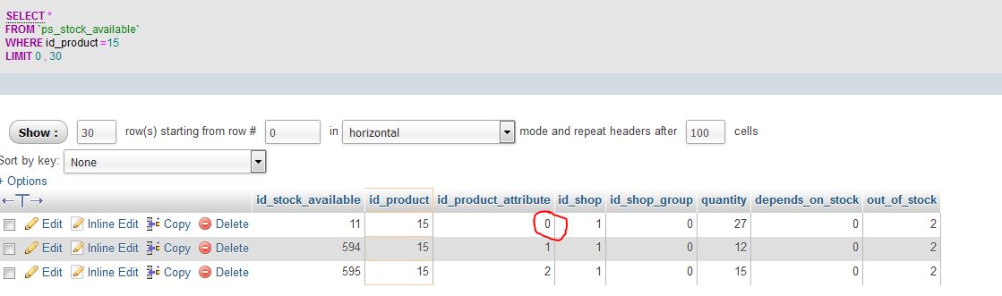

prestatent Posted March 8, 2016 Share Posted March 8, 2016 Hi If I understand you correctly you want to see the total for the product for all combinations. If so you need to add another record into the ps_stock_available table with : - id_product_attribute = 0 See attached screenshot for details. This should give you what you are looking for. Cheers 1 Link to comment Share on other sites More sharing options...

prestatent Posted March 8, 2016 Share Posted March 8, 2016 Hi For each product a "id_product_attribute" = 0 must exist for you to see the total in the product-list in the backend. If you have access to PHPMyAdmin, you should be able to see if a record exists or not. If not, you can manually add a record into the ps_stock_available table. The quantity should be the total of all quantities for all the attributes for the product. In my example the quantities for id_product_attributes 594 and 595 is 15 + 12 = 27. Link to comment Share on other sites More sharing options...
