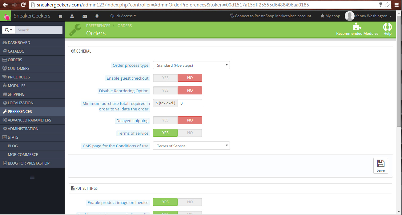

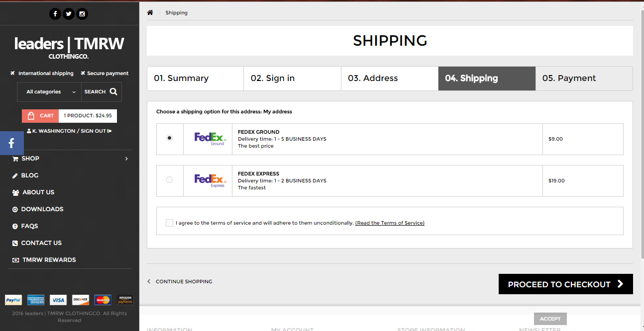

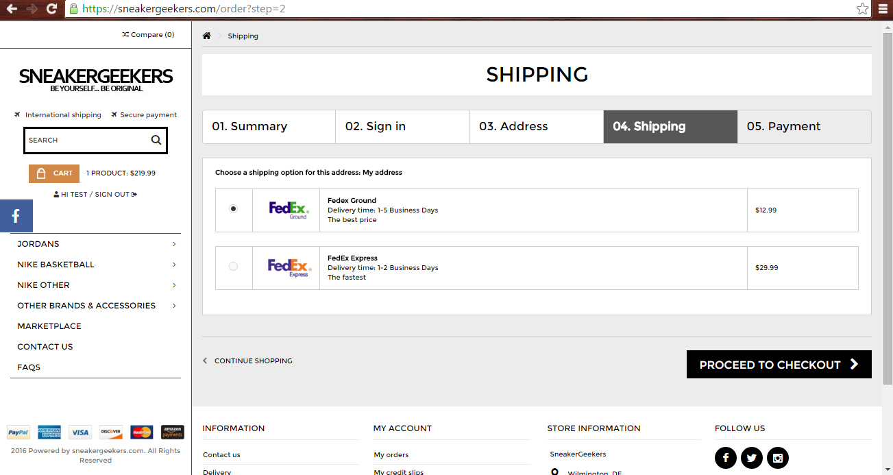

iiMKenny Posted March 4, 2016 Share Posted March 4, 2016 (edited) I've had an issue with my checkout process the last few days. Everytime a customer tries to checkout on my website the TOS checkbox isn't showing up on step 4, and I have it turned on in BO. I have another website with the same template and the checkbox shows up so it's something wrong with this website. I've attached a few photos to show what I'm referring to. Also I think this is tied to the TOS issue. Whenever I try to proceed to step 5 to complete the checkout process nothing happens it just reloads the same exact page for step 4. If someone could help me with this, I would greatly appreciate it, I've lost a few customers the last few days because of the checkout issue. The problem website is www.sneakergeekers.com try to checkout an item and you'll notice what i'm referring to. If you need my sign in credentials I will provide them. Edited March 4, 2016 by iiMKenny (see edit history) Link to comment Share on other sites More sharing options...
NemoPS Posted March 4, 2016 Share Posted March 4, 2016 They are not in the html source, so I have to guess your template's order-carrier.tpl has some condition in the file, depending on which it shows up or not. You should check for that Link to comment Share on other sites More sharing options...
