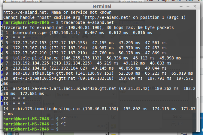

robinast Posted February 20, 2016 Share Posted February 20, 2016 PrestaShop 1.6.1.1 Server (inmotionhosting.com): Apache Version 2.4.16 PHP Version 5.5.32 MySQL Version 5.6.28 Architecture x86_64 Operating System linux I've got problems with the Prestashop installed at e-aiand.net: the backend is OK, but the frontend is completely missing. It's been all OK for several weeks. Must be something that I did today. Namely, I removed an old and broken Joomla installation from e-aiand.com and deleted several folders that had nothing to do (to my best knowledge) with Joomla or Prestashop. I did not touch anything at all at e-aiand.net. Also, I removed several unused (again, to my best knowledge) databases from older uninstalled applications. What may have went wrong? I am reaching the server. The site just never loads or errors out (in Firefox; Opera and Chrome give server error messages). See the attached file. Link to comment Share on other sites More sharing options...
