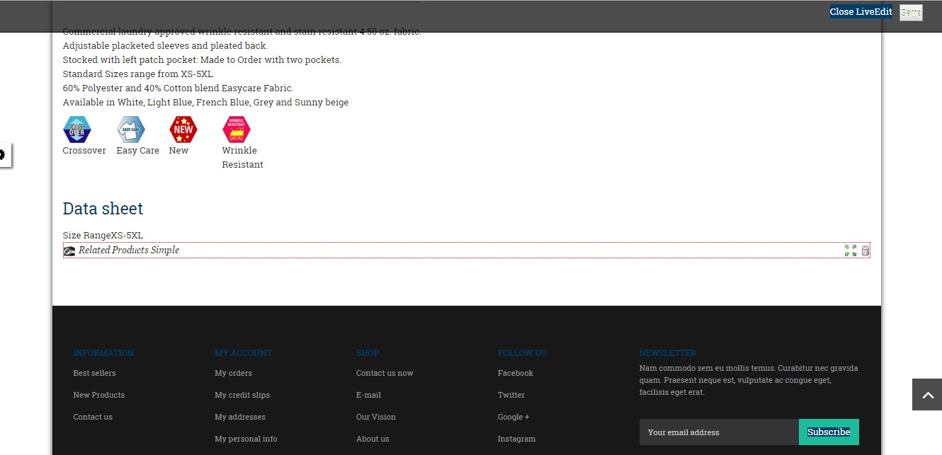

GMigi Posted February 6, 2016 Share Posted February 6, 2016 Hi I have downloaded a few modules and they have been installed and configured. While installing these modules they have been transplanted to their default hooks on the product page ("displayFooterProduct hook"). I do want them on the individual product page however they are not showing up in that position. In the live edit option, I can see the names of the modules there yet nothing is displayed. I'm using version 1.6 Thanks for any help you can give me. Link to comment Share on other sites More sharing options...

GMigi Posted February 10, 2016 Author Share Posted February 10, 2016 They are not showing up anywhere. This is the module that is used in the product footer Related Products Simple. When I run live edit, I only see an empty module in that position. Since Nemo mentioned the hooks on the default template would be different, I decided to test it out and then reverted back to the theme I'm using. In that the hook was showing up at the bottom of the footer page. But after the change, there is a layered slideshow on the homepage that stopped working, that is hooked to displaySlideshow. I'm not sure why this is the case. Can anyone help me resolve this issue please? Thanks! Link to comment Share on other sites More sharing options...
