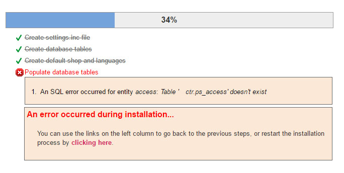

techkoop Posted February 6, 2016 Share Posted February 6, 2016 hi i have been searching to all the forums and communities. Everyone seems to have the same problem with 1.6.1.4. Tables do not exist,in the database, db-files do not have indexes,and simple apps like adding a product do not work in admin. Which version of prestashop 1.6 X should i install to work with a fresh and clean prestashop on localhost? I prefer to manage my shop on local host and use c:/xampp package. i work with a 64 bit machine with windows 10 home and 16Gb RAM, i used ports 8000 and 8433 for apache, blocked 80 and 433 in skype to be sure of a good database creation. It didn't help. The project is to get a shop suitable for one click upgrades. It's first stage will contain 3300 products divided over a lot of categories and with a lot of cool and comprehensive filters in the front end shop. Second stage will be over 50.000 products. I am really a fan of prestashop since the possibilities are endless but with all these errors i do not now if its still the best platform for me. Please get me a clean and working admin with an errorfree database. Greetz techkoop.nl 1 Link to comment Share on other sites More sharing options...

notebookcentro Posted March 27, 2016 Share Posted March 27, 2016 Actually, I have a perfectly running 1.6.1.4 on my local WAMP. I am assuming it has some conflict with XAMPP or its php/mysql versions Hello, please could you indicate what the correct settings to finish installing prestashop 1.6.1.4, as unfortunately, does not pass me 34% I am using wampserver latest version. Thank you Link to comment Share on other sites More sharing options...
NemoPS Posted March 29, 2016 Share Posted March 29, 2016 On WAMP? For me, I just drag and drop, then install. I don't have any specific configuration so it's hard to guide you. What is your php/mysql version on the local server? Link to comment Share on other sites More sharing options...
notebookcentro Posted March 29, 2016 Share Posted March 29, 2016 MySQL ver 5.7.9 PHP ver 7.0 Apache ver 2.4.17 Hello, Thanks for your concern. I think the problem lies in the db_structure file, since I have made some modifications and allows me to skip that part of 34% but fails later repeating the mistake, but in another section. I am a newbie, but something I understand, by your experience, could you tell me if this part of the code is well? SET SESSION sql_mode = ''; SET NAMES 'utf8';?CREATE TABLE `PREFIX_access` ( `id_profile` int(10) unsigned NOT NULL, `id_tab` int(10) unsigned NOT NULL, `view` int(11) NOT NULL, `add` int(11) NOT NULL, `edit` int(11) NOT NULL, `delete` int(11) NOT NULL, PRIMARY KEY (`id_profile`,`id_tab`) ) ENGINE=ENGINE_TYPE DEFAULT CHARSET=utf8 COLLATION; this symbol (?) in code is OK? Link to comment Share on other sites More sharing options...
selectshop.at Posted March 29, 2016 Share Posted March 29, 2016 XAMP on Windows 10 is buggy and don't work. Mamp is ok. No, the "?" is not ok. Try to downgrade your mysql database and php vers. I didn't yet tried php7 but php versions 5.6.x, 5.4x are working well. MYSQL use version 5.5.x instead. Link to comment Share on other sites More sharing options...
notebookcentro Posted March 29, 2016 Share Posted March 29, 2016 OK, I will try what you say, although I did. Would you be so kind as to share your db_structure file or code to compare with mine and see if I with the failure? Thank you for your comments. Regards!! Link to comment Share on other sites More sharing options...
selectshop.at Posted March 30, 2016 Share Posted March 30, 2016 Cannot tell you, cause this is a part of install.php. You should download the Prestashop package and verify on the /install folder the files there. I'm sure your php-version is replacing digits by another. There should be a " instead of ? Please check, or better: try to use the environment I've suggested. On this it is working, besides it does not make any sense to use latest technique, if you probably will not get a server with that technique (not on a shared hosting package ). I presume you will move the shop afterwards to a live server, or not ? AND please refrain form adding the same question in double. I moved the Spanish one to Spanish forum and the doblons I merged to your already added topics. Link to comment Share on other sites More sharing options...
NemoPS Posted March 30, 2016 Share Posted March 30, 2016 It might be php7, I heard it doesn't cope well with prestashop. Try with php 5.5 and mysql 5.5 as well Link to comment Share on other sites More sharing options...
azarian Posted April 10, 2016 Share Posted April 10, 2016 The cause of it is probably mysql 5.7, you should downgrade to mysql 5.5 and it will work probably work fine Link to comment Share on other sites More sharing options...
