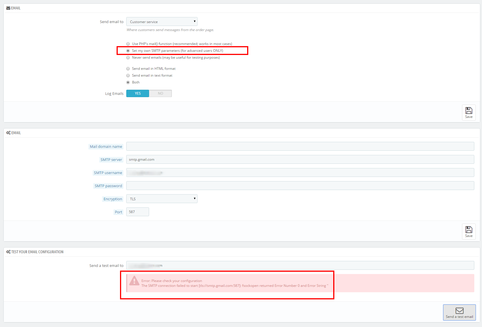

catzarov Posted February 2, 2016 Share Posted February 2, 2016 Hello to all, I use 1.6.1.4 (latest official version). I want to use gmail.com for my outgoing mail. I see the following error: I tried with SSL/TLS and port: 465 or 587 The problem continues to exist! My email in the store used the gmail.com (IMAP email is activated) I need your help, please tell me how to set up SMTP correctly in online store ? Thanks for the separate time for me. Link to comment Share on other sites More sharing options...
bellini13 Posted February 2, 2016 Share Posted February 2, 2016 Unfortunately you cannot with the software that Prestashop uses. It is 7+ years old and and does not support modern encryption that gmail and other modern SMTP gateway employ You can refer to this topic for additional information and a paid solution https://www.prestashop.com/forums/topic/270220-modification-swift-mailer-upgrade-better-support-for-ssltls/ I have heard there are settings in gmail that you can disable encryption, but I do not recommend doing that Link to comment Share on other sites More sharing options...
catzarov Posted February 3, 2016 Author Share Posted February 3, 2016 Thanks for the information. I was hoping for a free solution because the sent emails going into spam! If I use another SMTP (different from gmail) will work this feature ? Link to comment Share on other sites More sharing options...

tdr170 Posted February 3, 2016 Share Posted February 3, 2016 (edited) Thanks for the information. I was hoping for a free solution because the sent emails going into spam! If I use another SMTP (different from gmail) will work this feature ? Is this all mails going to spam or just certain ones, the reason I asked is I just had an issue with Out of stock emails going to spam and found that it was actually the code used in the mail. For some reason the Spam filter was seeing this as a marker of spam {last_qty} removing this and the mail came through I do not get it but the mail works now and there was another line with {qty) that shows the products available anyway. If you want to use SMTP you probably can use the mail of your internet provider, you could create another email just for the shop. If you look around in the mail section you will usually find some info on how to set up mail programs like Outlook, these settings worked for SMTP from Prestashop when I was testing. Edited February 3, 2016 by tdr170 (see edit history) Link to comment Share on other sites More sharing options...
