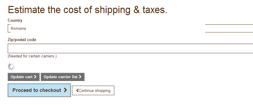

Rhobur Posted January 29, 2016 Share Posted January 29, 2016 Hello, I have upgraded a shop from 1.5.4.1 to 1.6.1.4. All issues were solved except one I cannot pinpoint. Despite having 2 carriers correctly set up in the checkout page they do not display. All that appear is the loading gif. Consequently the buy cannot be concluded because the payment page will issue an error of not having selected any carrier. No error displayed with dev mode set to true either. Any bright ideas please? Regards, Robert Link to comment Share on other sites More sharing options...

Rhobur Posted February 1, 2016 Author Share Posted February 1, 2016 Solved. Very stupid mistake, every thing was set correctly, prices, carriers, countries, etc except the delivery zone which was disabled for mine. What is strange is that in the default 5 steps checkout no error message appeared just the loading gif. Only when configuring the onecheckout page an error appeared and I could trace it back in the code in order to figure out what the problem was. Link to comment Share on other sites More sharing options...
