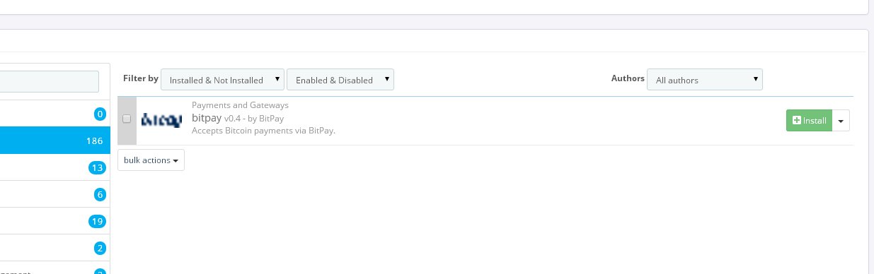

tdr170 Posted January 28, 2016 Share Posted January 28, 2016 I have fixed your issue its not Prestashop its the way they zipped the file it is several folders in and that is not how it works and why they want you to upload the file. However there is an issue in that the bitpay folder is inside the modules folder of the unzipped file you would need to upload just the bitpay folder to your modules folder. I tried in my 1.6.1.4 test site and same as you module would not show after adding from back office so I unzipped it and found the issue. When you unzip any module look at the structure anly upload the actual module folder not any other folder. So the unzipped folfder structure was like this: bitpay-prestashop-plugin-3b2bdb3 /modules /bitpay in this case only the Bitpay folder should be upload to the modules folder. This also does not work for adding from the BO if you unzip the zip file I povided you will see that it only has 1 folder bitpay NO NEED FOR THAT, I unzipped and recreated the zip file in the correct format to install through the Add new module from the back office. Download this file and add it as a new module as you did before and all will be well. bitpaypayment.zip Once you have this whats the next module, are you getting support Link to comment Share on other sites More sharing options...

brohemath Posted January 28, 2016 Author Share Posted January 28, 2016 (edited) I have fixed your issue its not Prestashop its the way they zipped the file it is several folders in and that is not how it works and why they want you to upload the file. However there is an issue in that the bitpay folder is inside the modules folder of the unzipped file you would need to upload just the bitpay folder to your modules folder. I tried in my 1.6.1.4 test site and same as you module would not show after adding from back office so I unzipped it and found the issue. When you unzip any module look at the structure anly upload the actual module folder not any other folder. So the unzipped folfder structure was like this: bitpay-prestashop-plugin-3b2bdb3 /modules /bitpay in this case only the Bitpay folder should be upload to the modules folder. This also does not work for adding from the BO if you unzip the zip file I povided you will see that it only has 1 folder bitpay NO NEED FOR THAT, I unzipped and recreated the zip file in the correct format to install through the Add new module from the back office. Download this file and add it as a new module as you did before and all will be well. bitpaypayment.zip Image1.jpg Once you have this whats the next module, are you getting support thank you so much for this. I now will be able to use latest version of 1.6 and won't have to redesign the whole shop. Could you share these with Github developers? I know if the correct formatted zips where there you will get a lot less support threads to deal with there. The support is awesome, I mean you went above and beyond fixing third party module folders and it is appreciated. And I agree with everything you said, that we need to move forward to 1.6 and not backwards, thank you for making that possible with my shops. Edited January 28, 2016 by brohemath (see edit history) Link to comment Share on other sites More sharing options...
