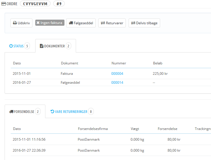

rbuelund Posted January 27, 2016 Share Posted January 27, 2016 (edited) Please see attached image. After having tampered with some settings around VAT all of a sudden invoices are not generated anymore (At least not correct). The date is not the correct date but has been set back to 01-11-2015 - also on the shipment?? What is going on here ??? Using latest 1.6.1.4 Also the invoice number shown is not correct - it should be #15 insted of 4 ??? Edited January 27, 2016 by rbuelund (see edit history) Link to comment Share on other sites More sharing options...

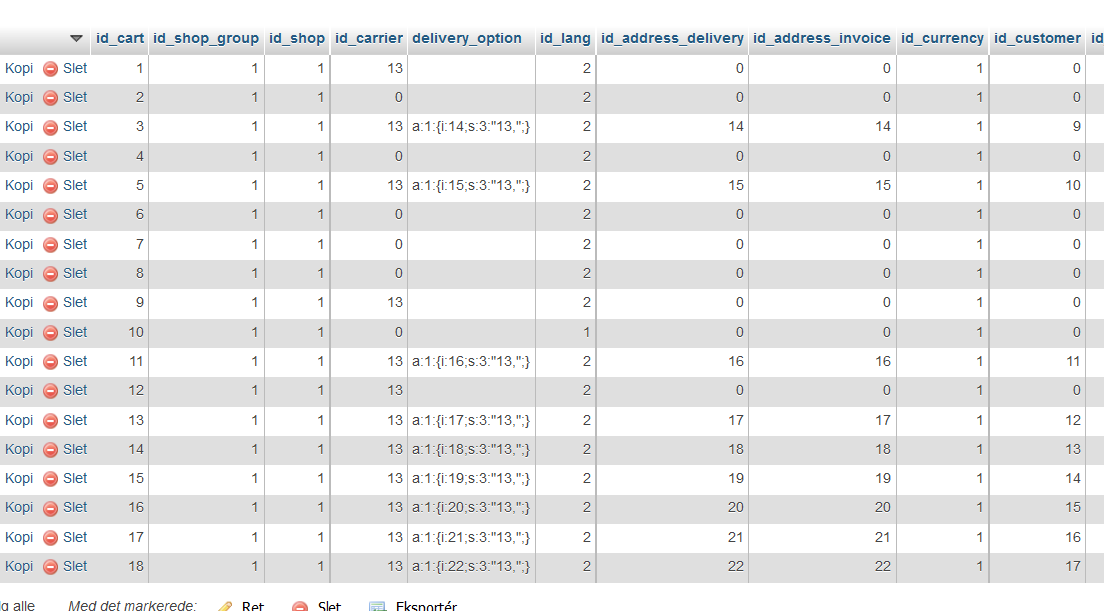

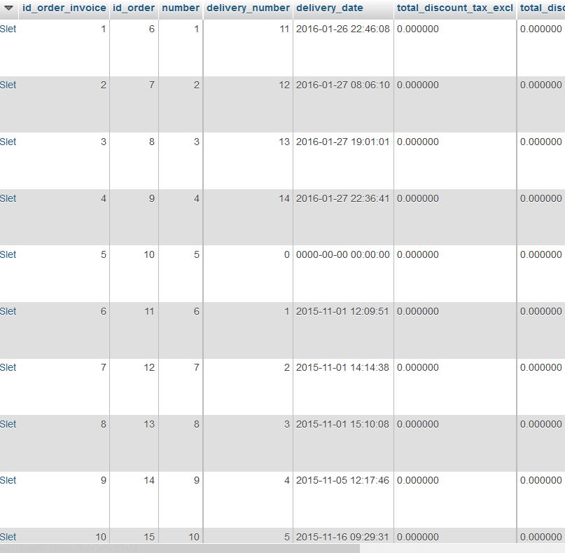

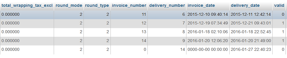

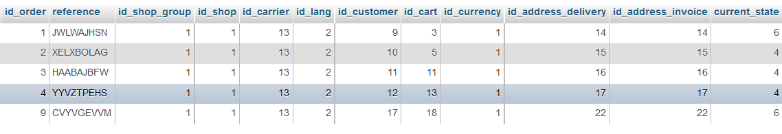

rbuelund Posted January 28, 2016 Author Share Posted January 28, 2016 Please see attached images of db tables - i cannot see where the crossing should be ?? I have not been altering in the database - so what is wrong here ?? Link to comment Share on other sites More sharing options...
tdr170 Posted January 28, 2016 Share Posted January 28, 2016 No I dont see it in these small snaps what you want to look for is either a order id cariier id customer in that was made on this date and see if you can find something crossed. At one point I added orders from my online store to a new store I was working on and had some new orders showing older order info. That is what made me think of this after looking and looking I finally found that teh cart ids were wrong for the new orders corrected in the database and all was well. Im not guaranteeing this is the issue both worth taking the time ti investigate. Look at teh orders with the wrong date find the order id cart id and invoice id and look through the database tables with this info and see if you find matching ids. Link to comment Share on other sites More sharing options...
eleazar Posted January 28, 2016 Share Posted January 28, 2016 I don't know how this error happened, but you will find the informations that Prestashop uses for the pdf invoice in the table ps_order_invoice, which is not among your posted images. However, it seems that from a certain point on the server didn't provide the correct date (and time?) to generate the time stamps stored in the database. Link to comment Share on other sites More sharing options...
rbuelund Posted January 28, 2016 Author Share Posted January 28, 2016 Ehmm.. my last image IS of the order_invoice table - and i cannot see any cross problems. All of a sudden the system just has started generating invoices with wrong number and date .... please help! Link to comment Share on other sites More sharing options...
