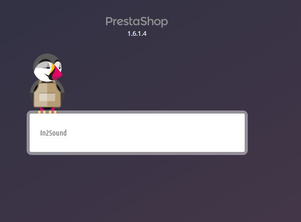

René Kuenen Posted January 27, 2016 Share Posted January 27, 2016 (edited) Hello, I had 1.6.0.14 and did the autoupgrade to 1.6.1.4 After that i cannot login. It give me the login screen where I can put the login credentials. When I do that and want to login it gives me a screen with only the shopname. Noting happens, no error (see picture). Also debugging give's me no error. When I use wrong credentials, it tells me, so I think it's in the redirect or something. Not prestashop modules turned off. What could I do to solve this Edited January 27, 2016 by René Kuenen (see edit history) Link to comment Share on other sites More sharing options...
Simonas Invertus Posted January 28, 2016 Share Posted January 28, 2016 This is the problem with the module, one of them is breaking your login screen. 1) Turn on debug mode 2) Click F12 in Chrome and look for error in ajax response. You will see which module breaks the system. 3) Login into your FTP delete that module. As far as I know this is the only solution. Link to comment Share on other sites More sharing options...
René Kuenen Posted January 28, 2016 Author Share Posted January 28, 2016 Thanks for the response. I get this: POST https://in2sound.nl/shop/admin5977/ajax-tab.php?rand=1453982354242 500 (Internal Server Error) No idea with module to look for . Link to comment Share on other sites More sharing options...
Simonas Invertus Posted January 28, 2016 Share Posted January 28, 2016 There are a lot of forum post about 500 error. Look error log for the real problem. Link to comment Share on other sites More sharing options...
