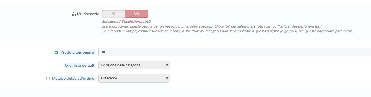

Black Shine Posted January 26, 2016 Share Posted January 26, 2016 hai controllato in impostazioni-->prodotti se la paginazione è in base alla categoria? Link to comment Share on other sites More sharing options...
robertovec Posted January 26, 2016 Author Share Posted January 26, 2016 ecco l'allegato Link to comment Share on other sites More sharing options...
