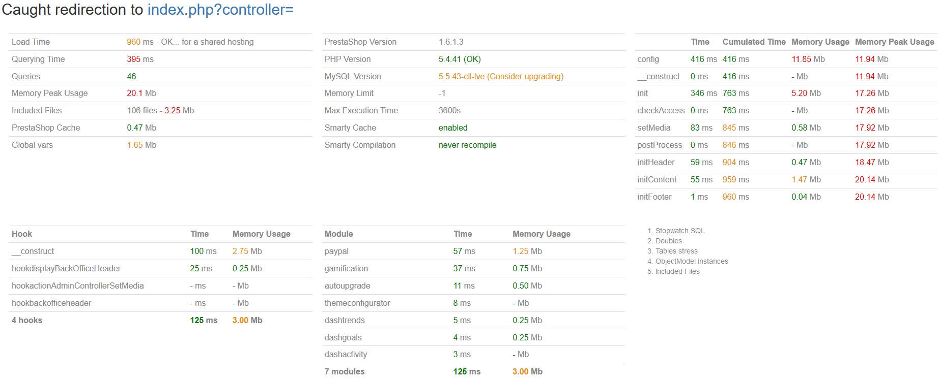

mydistrib Posted January 26, 2016 Author Share Posted January 26, 2016 Alors voici un extrait des paramètres : /* Debug only */if (!defined('_PS_MODE_DEV_')) {define('_PS_MODE_DEV_', true);}/* Compatibility warning */define('_PS_DISPLAY_COMPATIBILITY_WARNING_', false);if (_PS_MODE_DEV_ === true) { @ini_set('display_errors', 'on'); @error_reporting(E_ALL | E_STRICT); define('_PS_DEBUG_SQL_', true);} else { @ini_set('display_errors', 'on'); define('_PS_DEBUG_SQL_', true);}define('_PS_DEBUG_PROFILING_', true);define('_PS_MODE_DEMO_', false); Link to comment Share on other sites More sharing options...
mydistrib Posted January 26, 2016 Author Share Posted January 26, 2016 Malgré ces réglages, quand je vais sur le front office ou quand j'essaye de consulter ma page produits, je tombe sur une page blanche avec une erreur 500 sans plus de details que ça. Ma version de prestashop est la 1.6.1.3 Link to comment Share on other sites More sharing options...

mydistrib Posted January 26, 2016 Author Share Posted January 26, 2016 Alors voici une piste sur le log à l'emplacement /var/www/vhosts/xxxx/logs/xxxxx.com: [Tue Jan 26 18:43:02 2016] [warn] [client xx.xxx.xx.xxx] (104)Connection reset by peer: mod_fcgid: error reading data from FastCGI server[Tue Jan 26 18:43:02 2016] [error] [client xx.xxx.xx.xxx] Premature end of script headers: index.php[Tue Jan 26 18:49:10 2016] [warn] [client xx.xx.xxx.xx] (104)Connection reset by peer: mod_fcgid: error reading data from FastCGI server[Tue Jan 26 18:49:10 2016] [error] [client xx.xx.xxx.xx] Premature end of script headers: index.php[Tue Jan 26 18:49:10 2016] [warn] [client xx.xx.xxx.xx] (104)Connection reset by peer: mod_fcgid: error reading data from FastCGI server[Tue Jan 26 18:49:10 2016] [error] [client xx.xx.xxx.xx] Premature end of script headers: index.php[Tue Jan 26 18:50:07 2016] [error] [client xx.xxx.xx.xxx] File does not exist: /var/www/vhosts/xxx/xxx.com/camera-kits[Tue Jan 26 18:56:07 2016] [error] [client xx.xxx.xx.xxx] File does not exist: /var/www/vhosts/xxx/xxx.com/tablet-pc[Tue Jan 26 18:56:19 2016] [error] [client xxx.xxx.xxx.xxx] File does not exist: /var/www/vhosts/xxx/xxx.com/accessoires-auto[Tue Jan 26 18:57:15 2016] [warn] [client xx.xxx.xx.xxx] (104)Connection reset by peer: mod_fcgid: error reading data from FastCGI server[Tue Jan 26 18:57:15 2016] [error] [client xx.xxx.xx.xxx] Premature end of script headers: index.php[Tue Jan 26 18:59:10 2016] [error] [client xx.xxx.xx.xxx] File does not exist: /var/www/vhosts/xxx/xxx.com/275276-thickbox_default[Tue Jan 26 18:59:30 2016] [error] [client xx.xxx.xx.xxx] File does not exist: /var/www/vhosts/xxx/xxx.com/camera-kits A priori des fichiers qui n'existent pas, mais je ne sais pas qui fait appel à ces fichiers. Peut être des produits présents à l'origine sur la page d'accueil qui n'existent plus? Qu'est ce qui peut causer l'erreur FCGID ? Link to comment Share on other sites More sharing options...
doekia Posted January 26, 2016 Share Posted January 26, 2016 (edited) File does not exists car ton .htacces n'est pas lu (permission ou absent) FCGID parti en vacances ça peut être version de PHP et librairies foireux (voir le log système pour identifier ce genre de cause) mais là ça dit timeout Tu as un php qui prend plus de 30s (le timeout defaut de fcgid) donc le process ce barre et laisse ton navigateur à sa partie de carte tout seul. Ton problème provient probablement d'une "maladie" dans ton prestashop qui rend ton système tellement lent que ça part en sucette partout. Verifier bdd ( tuning ) Après dans la mesure où tu nous demande notre avis j'espère que tu ne nous a rien caché ... genre mise à jour à l'arrache et compagnie Si c'est le cas alors on peut envisager une base de donnée ayant perdu toute intégrité et provoquant la misère partout. Edited January 26, 2016 by doekia (see edit history) Link to comment Share on other sites More sharing options...
