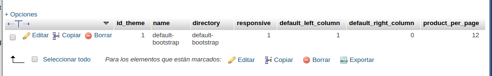

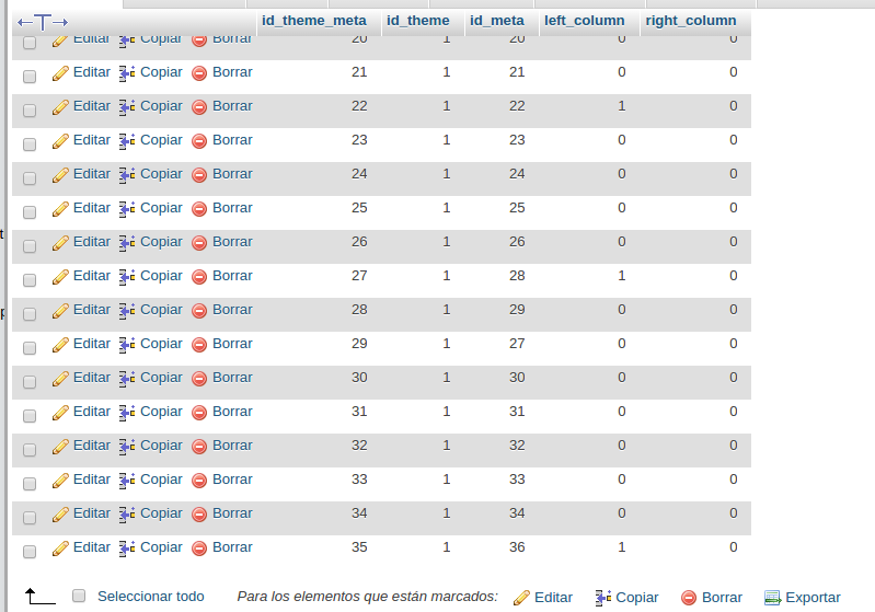

cristianfpg Posted January 26, 2016 Author Share Posted January 26, 2016 change default bootstrap with my theme, its ok product per page, columns, i can modify later in backoffice i think but ps_theme_meta... what is this? Link to comment Share on other sites More sharing options...
tdr170 Posted January 26, 2016 Share Posted January 26, 2016 (edited) You do not need to change it just add as ID 2 and give the same settings as default theme. Upload the theme to the themes folder should have 2 folder inside the themes folder when done. /themes/ default-bootstrap your new theme Before Proceeding BACK UP YOUR DATABASE. Now just use the database tables I have included copy and paste, use SQL from top menu paste into text area and click go this will over wright the tables adding the new theme and directory. You will need to change the second line that says your-new-theme to the name of your theme be exact here. (in red) If you changed your database prefix ps_ then you will need to change each instance of that. Copy everything including the -- -- -- Table structure for table `ps_theme` -- DROP TABLE IF EXISTS `ps_theme`; CREATE TABLE IF NOT EXISTS `ps_theme` ( `id_theme` int(11) NOT NULL AUTO_INCREMENT, `name` varchar(64) NOT NULL, `directory` varchar(64) NOT NULL, `responsive` tinyint(1) NOT NULL DEFAULT '0', `default_left_column` tinyint(1) NOT NULL DEFAULT '0', `default_right_column` tinyint(1) NOT NULL DEFAULT '0', `product_per_page` int(10) unsigned NOT NULL, PRIMARY KEY (`id_theme`) ) ENGINE=InnoDB DEFAULT CHARSET=utf8 AUTO_INCREMENT=3 ; -- -- Dumping data for table `ps_theme` -- INSERT INTO `ps_theme` (`id_theme`, `name`, `directory`, `responsive`, `default_left_column`, `default_right_column`, `product_per_page`) VALUES (1, 'default-bootstrap', 'default-bootstrap', 1, 1, 0, 12), (2, 'your-new-theme', 'your-new-theme', 1, 1, 0, 12); Now for the Meta just copy and paste this as you did with above code. (change nothing) -- -- Table structure for table `ps_theme_meta` -- DROP TABLE IF EXISTS `ps_theme_meta`; CREATE TABLE IF NOT EXISTS `ps_theme_meta` ( `id_theme_meta` int(11) NOT NULL AUTO_INCREMENT, `id_theme` int(11) NOT NULL, `id_meta` int(10) unsigned NOT NULL, `left_column` tinyint(1) NOT NULL DEFAULT '1', `right_column` tinyint(1) NOT NULL DEFAULT '1', PRIMARY KEY (`id_theme_meta`), UNIQUE KEY `id_theme_2` (`id_theme`,`id_meta`), KEY `id_theme` (`id_theme`), KEY `id_meta` (`id_meta`) ) ENGINE=InnoDB DEFAULT CHARSET=utf8 AUTO_INCREMENT=78 ; -- -- Dumping data for table `ps_theme_meta` -- INSERT INTO `ps_theme_meta` (`id_theme_meta`, `id_theme`, `id_meta`, `left_column`, `right_column`) VALUES (1, 1, 1, 0, 0), (2, 1, 2, 1, 0), (3, 1, 3, 0, 0), (4, 1, 4, 0, 0), (5, 1, 5, 1, 0), (6, 1, 6, 1, 0), (7, 1, 7, 0, 0), (8, 1, 8, 1, 0), (9, 1, 9, 1, 0), (10, 1, 10, 0, 0), (11, 1, 11, 0, 0), (12, 1, 12, 0, 0), (13, 1, 13, 0, 0), (14, 1, 14, 0, 0), (15, 1, 15, 0, 0), (16, 1, 16, 0, 0), (17, 1, 17, 0, 0), (18, 1, 18, 0, 0), (19, 1, 19, 0, 0), (20, 1, 20, 0, 0), (21, 1, 21, 0, 0), (22, 1, 22, 1, 0), (23, 1, 23, 0, 0), (24, 1, 24, 0, 0), (25, 1, 25, 0, 0), (26, 1, 26, 0, 0), (27, 1, 28, 1, 0), (28, 1, 29, 0, 0), (29, 1, 27, 0, 0), (30, 1, 30, 0, 0), (31, 1, 31, 0, 0), (32, 1, 32, 0, 0), (33, 1, 33, 0, 0), (34, 1, 34, 0, 0), (35, 1, 36, 1, 0), (36, 1, 37, 1, 0), (37, 1, 38, 1, 0), (38, 1, 39, 1, 0), (39, 2, 1, 1, 0), (40, 2, 2, 1, 0), (41, 2, 3, 1, 0), (42, 2, 4, 1, 0), (43, 2, 5, 1, 0), (44, 2, 6, 1, 0), (45, 2, 7, 1, 0), (46, 2, 8, 1, 0), (47, 2, 9, 1, 0), (48, 2, 10, 1, 0), (49, 2, 11, 1, 0), (50, 2, 12, 1, 0), (51, 2, 13, 0, 0), (52, 2, 14, 1, 0), (53, 2, 15, 1, 0), (54, 2, 16, 1, 0), (55, 2, 17, 1, 0), (56, 2, 18, 1, 0), (57, 2, 19, 1, 0), (58, 2, 20, 1, 0), (59, 2, 21, 1, 0), (60, 2, 22, 1, 0), (61, 2, 23, 1, 0), (62, 2, 24, 0, 0), (63, 2, 25, 1, 0), (64, 2, 26, 0, 0), (65, 2, 28, 1, 0), (66, 2, 29, 1, 0), (67, 2, 27, 1, 0), (68, 2, 30, 1, 0), (69, 2, 31, 1, 0), (70, 2, 34, 1, 0), (71, 2, 36, 1, 0), (72, 2, 33, 1, 0), (73, 2, 32, 1, 0), (74, 2, 37, 1, 0), (75, 2, 38, 1, 0), (76, 2, 39, 1, 0), (77, 2, 35, 1, 0); Let me know how it goes. Edited January 26, 2016 by tdr170 (see edit history) Link to comment Share on other sites More sharing options...
cristianfpg Posted January 26, 2016 Author Share Posted January 26, 2016 ok, the new theme appears enable in my backoffice, but when i refresh my shop with this theme selected, bum... error 500, return the old theme and the shop works again... i think those are 3 additional rows (36-38) in ps_theme_meta what do you think about this? Link to comment Share on other sites More sharing options...
