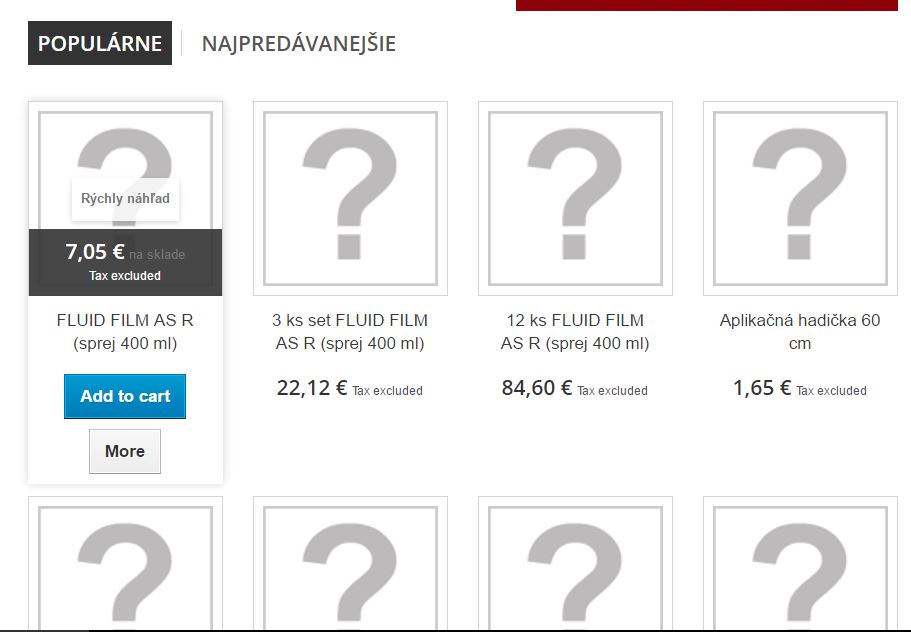

JanM Posted March 10, 2016 Share Posted March 10, 2016 Vie mi niekto pomoct? Ked som na stranke neprihlaseny tak vidim vsetky obrazky, ale ked chcem vyskusat urobit objednavku a prihlasim sa vidim iba otazniky. link na moj testovaci web: http://fifth-element.pswebstore.com/sk/?live_configurator_token=b845ddab6b18e412c3691fa695a8c67a&id_employee=2&id_shop=3 obrazok po prihlaseni: Vopred dakujem Link to comment Share on other sites More sharing options...
