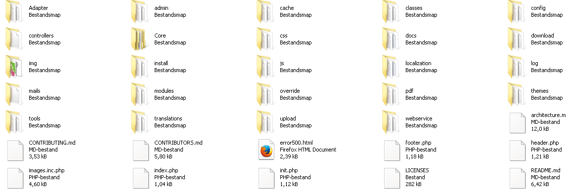

tvanderv Posted January 14, 2016 Share Posted January 14, 2016 Hello, I have been trying to install Prestashop withouth any luck, everytime i come up with a blank page. At first i thought it was something to do with my firewall(kaspersky) and added it to exclusions and have turned it off multiple times without results. Second thing i have done is restart the server and db and this has not worked. I looked at the logs and found this error: client 127.0.0.1:54067] PHP Fatal error: Class 'Core_Business_ContainerBuilder' not found in C:\\dev\\config\\bootstrap.php on line 27, referer: http://127.0.0.1:1111/index.php And I looked in my Core folder and it did not have the Business map, so i redownloaded prestashop and extracted it into a new map. So when i tried to install again i still came up with a blank page and the same error. Environment EasyPHP Devserver 16.1 consisting of APACHE 2.4.18(PHP 5.6.17) MYSQL(5.7.10) Folderstructure see attachment. Is there anyway to solve this problem and how? Kind regards tvanderv Link to comment Share on other sites More sharing options...
