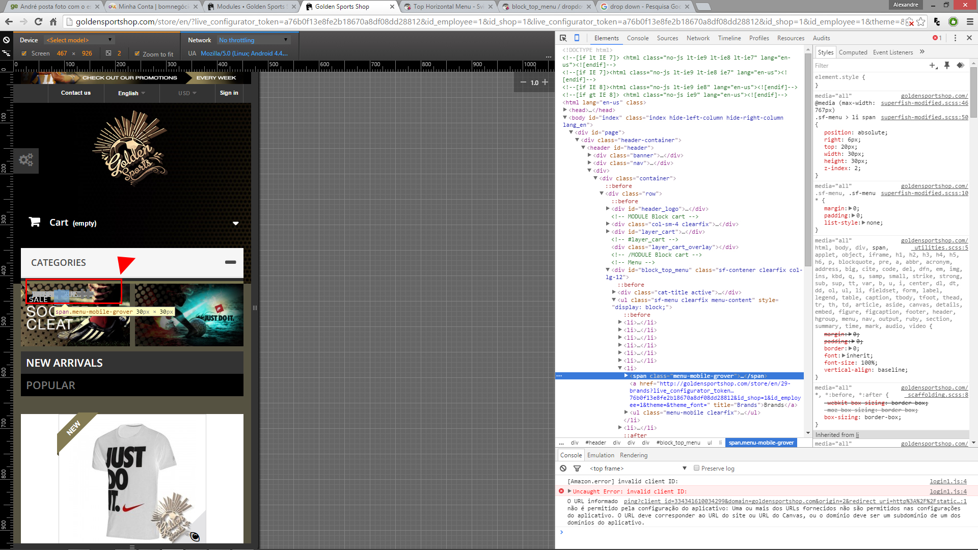

Problem With Horizontal Menu - Dropdown ( Mobile Mode )
That is caused by position:absolute;
@media (max-width: 767px)
.sf-menu > li {
    float: none;
    position: absolute;
    border-right: none;
in themes/default-bootstrap/css/modules/blocktopmenu/css/superfish-modified.css
Removing that line could help but check if it does not influence on something else.
You're the best ! Thank you very much .
everything is working fine now. I had to make a couple of modifications using some examples that I've found here before your correct answer for my problem , the reason you saw the css different of the default theme .
Thanks !!
