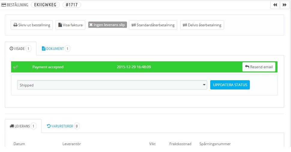

Kaprylo Posted January 4, 2016 Share Posted January 4, 2016 In the order status window when I select "Shipped" and update. Nothing happens ! I get no error logs, cleared the cache. I have the latest update of presto. Any1 else have this issue or got any hints ? Link to comment Share on other sites More sharing options...

Kaprylo Posted January 5, 2016 Author Share Posted January 5, 2016 Thank you Ron ! I tryed a diffrent browser and nothing happend there either. I changed all to true and saved. Tested the ordar status and nothing happend. Now I found a 2nd problem. I was checking for error logs when I pushed the reset button it did't reset. I don't know if it is connected to it. Link to comment Share on other sites More sharing options...

Kaprylo Posted January 6, 2016 Author Share Posted January 6, 2016 Hello Vekia !I manged to find this thread. It was the exact problem. https://www.prestashop.com/forums/topic/496689-incompatibilidad-entre-prestashop-y-php-56/ I am gonna try this if it works https://www.prestashop.com/forums/topic/380497-problem-with-php-56x-suhosin-and-empty-post-variables/ Link to comment Share on other sites More sharing options...

Kaprylo Posted February 7, 2016 Author Share Posted February 7, 2016 Hello Doriz ! Yes my host provider hade updated to the last php. So I told them to reverse it to last one I hade. Then it worked. Also if you have the latest presto version you could prob update to the latest php and it should work. This was a 1 weak headace for me. I really hope this could work for you Best Regards Kaprylo Link to comment Share on other sites More sharing options...
