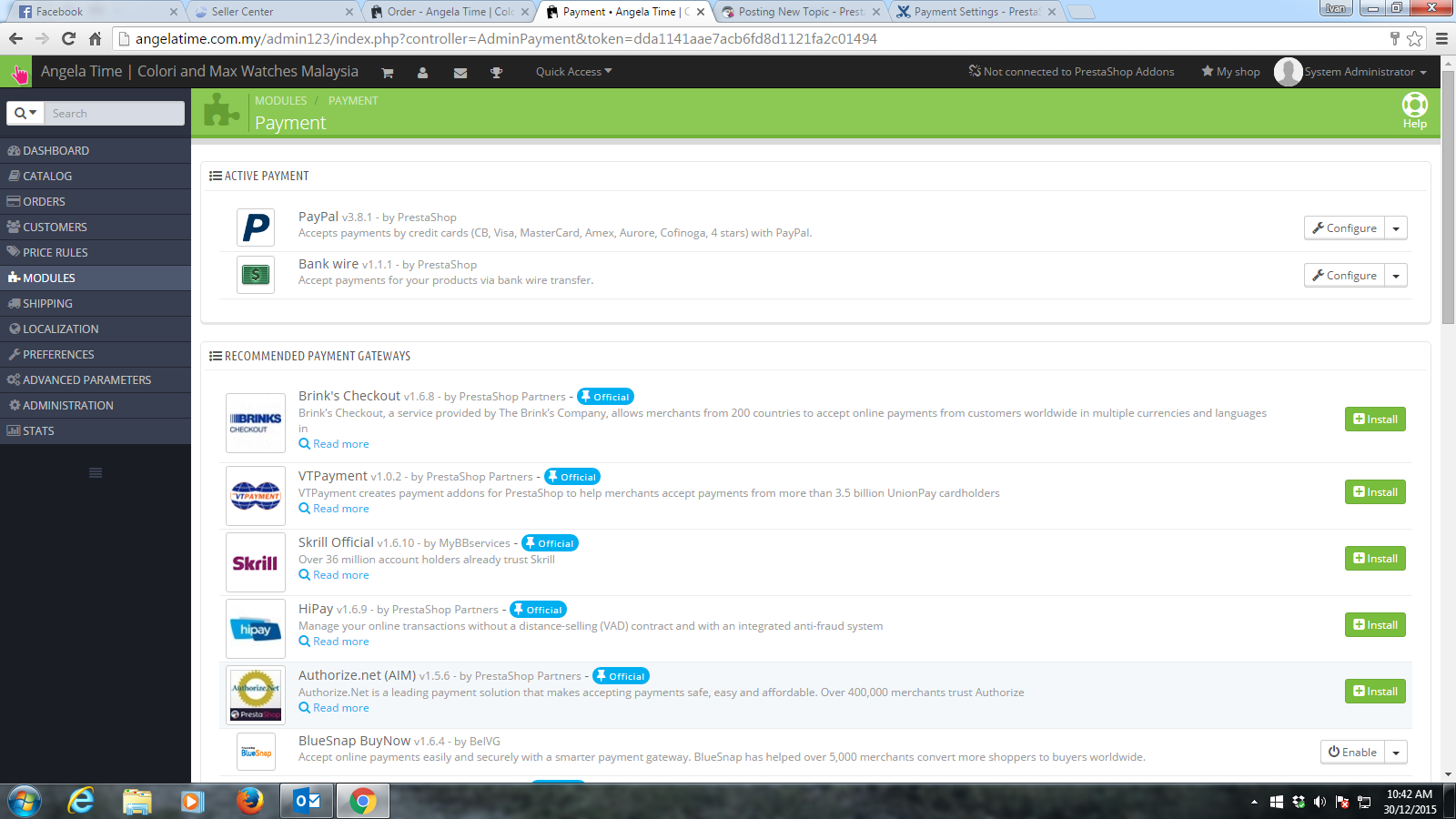

palmtah Posted December 30, 2015 Share Posted December 30, 2015 I have installed the Bank Wire Module but it doesn't show up while check out for payment. May i know what is the problem with it? Please find my attachment to see the printscreen pages. Thanks for advise. Link to comment Share on other sites More sharing options...

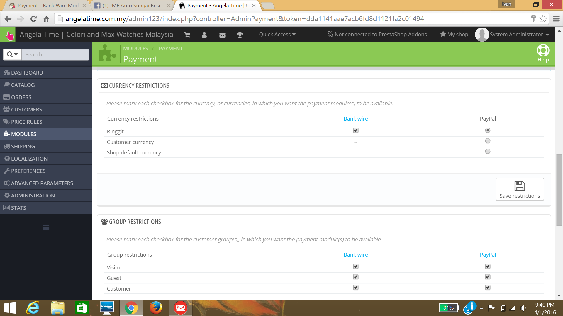

palmtah Posted January 4, 2016 Author Share Posted January 4, 2016 Hi, i set the bank wire and paypal option only available for our currency to be Ringgit Malaysia (RM) only. Not available for customer currency. Link to comment Share on other sites More sharing options...
NemoPS Posted January 4, 2016 Share Posted January 4, 2016 What if you try with customer currency and only enable RM anyway in the back office? Or do you need multiple? Link to comment Share on other sites More sharing options...
palmtah Posted January 4, 2016 Author Share Posted January 4, 2016 For Bank Wire option, only available for Ringgit Malaysia (RM). Either on Paypal option, i can only select one. Please find the attachment on printscreen. Thanks Link to comment Share on other sites More sharing options...
bellini13 Posted January 4, 2016 Share Posted January 4, 2016 The bankwire module should appear if you have RM currency selected. Link to comment Share on other sites More sharing options...
NemoPS Posted January 6, 2016 Share Posted January 6, 2016 Bellini is right. At this point, enable dev mode (see my signature), and check if any error pops up. Also switch between 5 steps and opc and see if it appears Link to comment Share on other sites More sharing options...
