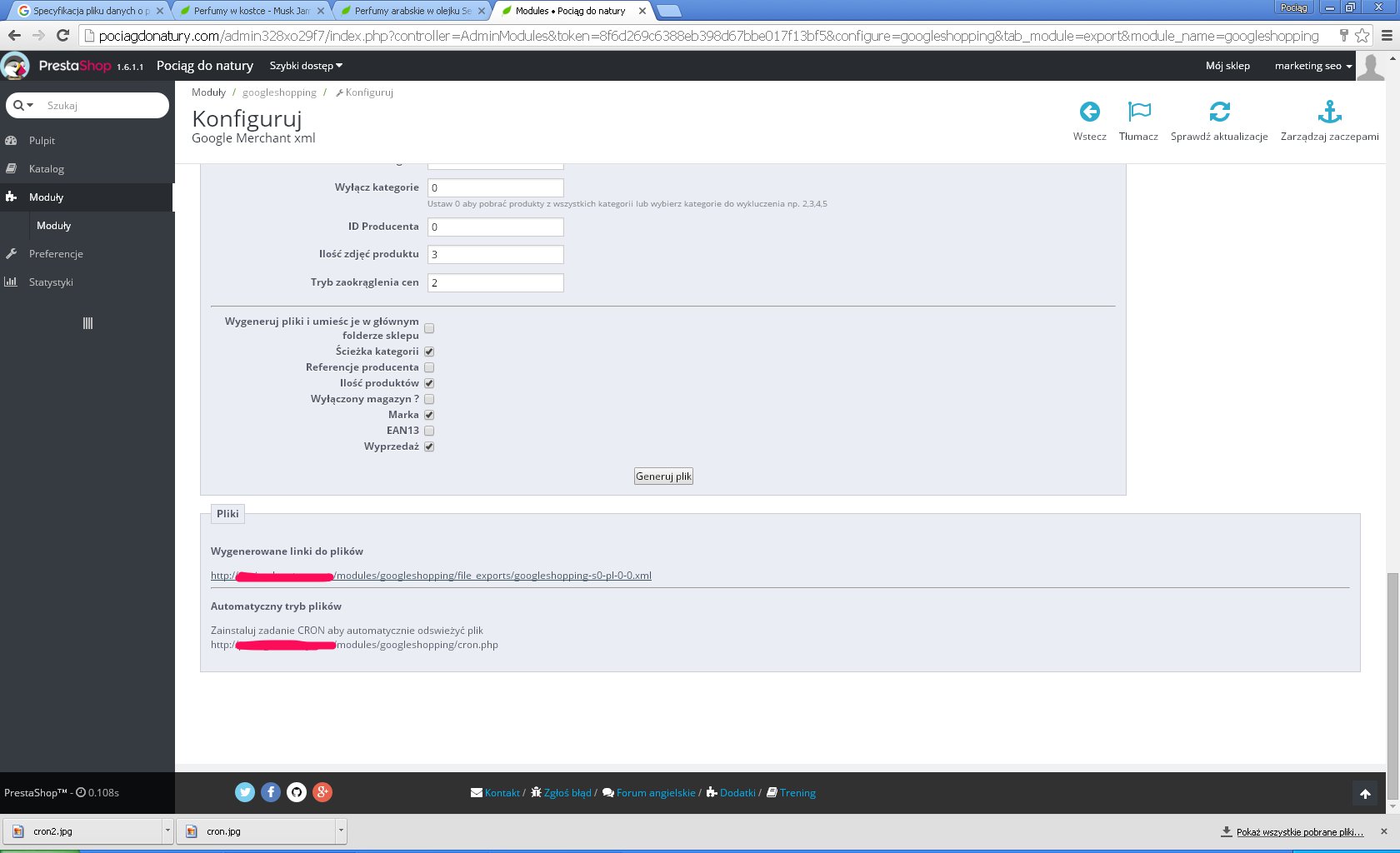

miyamoto1 Posted December 29, 2015 Share Posted December 29, 2015 I'm using cron task manager v 1.3.2 I've sheduled task to generate xml file for merchant center everyday but cron task doesn't work. As a link i pasted <mysite>/modules/googleshopping/cron.php. Do i need to add something more to the link? Link to comment Share on other sites More sharing options...

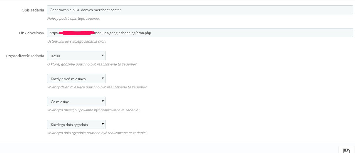

miyamoto1 Posted January 5, 2016 Author Share Posted January 5, 2016 It's 1.6.1 but i can't attach this, since i don't have full access to the shop. Current task is set up like this(screen), link comes from google shopping module Link to comment Share on other sites More sharing options...
im_presto Posted January 5, 2016 Share Posted January 5, 2016 you set up correctly the cron for google, but you need to set up cron script at server too. for an example : * * * * * php -f /home/myjowc5/public_html/modules/cron/cron_crontab.php Link to comment Share on other sites More sharing options...
